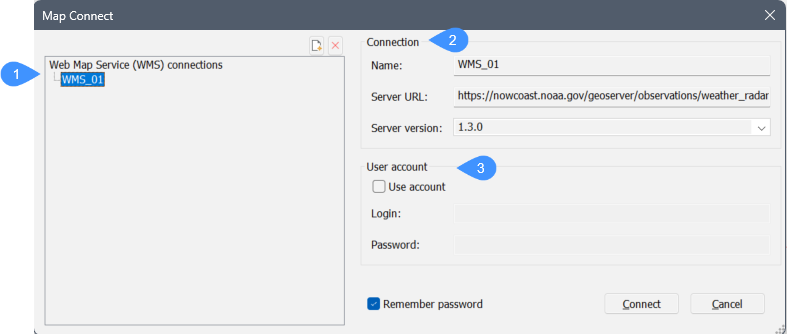

Opens the Map Connect dialog box to define a connection to a WMS server. Once connected, the Select Map Data dialog box appears.
WMS connections
Displays a list of available WMS connections.
Connection
Defines a WMS connection.
Name
Specifies the name for the connection.
Server URL
Specifies the URL of the WMS server to connect to.
Server version
Specifies the server version by choosing one from the drop-down list.
User account
Specifies the credentials for servers that require authentication.
Use account
If checked, you can log in using a user name and password.
Login
Specifies the user name for the account.
Password
Specifies the account password.
Remember passwords
If checked, saves the user name and password for future connections.
Connect
Connects to the Web Map Server and opens the Select Map Data dialog box.
