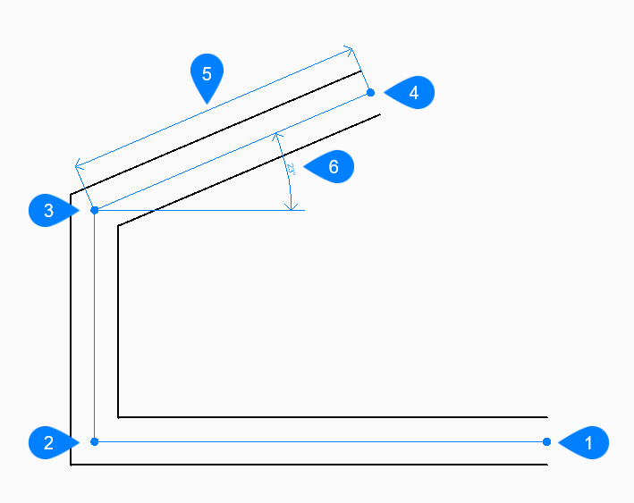

Creates a single MLine entity with multiple parallel lines and segments by specifying the start and endpoint of each segment. The MLine is based on the current multiline style. Options allow you to specify the justification and scale.
- Start
- Next
- Next
- End
- Length
- Angle
