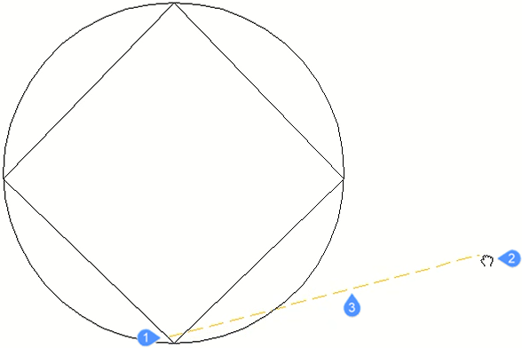

Method
There are two methods to use -PAN command:
- Pick a base point and a displacement point.
- Choose one of the predefined options.
- Pan base point.
- Pan cursor which specifies the pan displacement point.
- Pan displacement.
