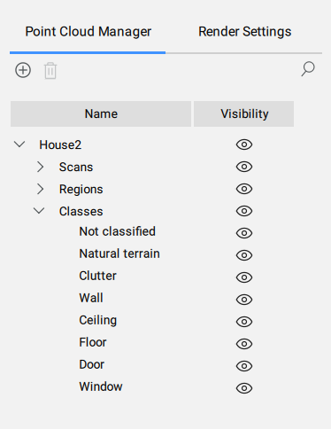

When the process ends, the results appear in the Point Cloud Manager panel under Classes (POINTCLOUDMANAGERPANELOPEN command).
