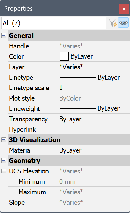

Properties list (current selection set)
The Properties list only displays properties that are valid for all the selected or filtered entities. The more types of entities you select, the fewer properties are available on the Properties list. Filter the entity list to view and modify properties for multiple entities of the same type with minimal effort. When two or more entities are selected, the properties show their common values. Properties that differ between the selected entities are shown as *varies*.
Note:
  • When area calculations take longer than three seconds, temporary yellowish node labeled "Computing..." is inserted in Properties panel. Even if you interrupt the calculation by pressing Esc in the Properties panel, the entities remain highlighted and their properties are available for the user.
  • The mass properties of 3D solids and surfaces are visible in the Properties panel when multiple entities are selected.
All entities display General, 3D Visualization (Model space only), and Geometry properties. Additional properties may display for certain types of entities.
General Properties
In Properties mode, when entities are selected, General properties describe properties that are applied to the selected entities and are valid for almost any type of entity. Besides the properties that are available when no entity is selected, there are:
Handle (read only)
Describes the unique hexadecimal value by which the selected entity is identified in the DWG database.
Plot style
Describes the plot style of the selected entity. You can specify a new plot style from the drop-down list. Note that this property is only available when plot styles are enabled. Also see the PLOTSTYLE command
Hyperlink
Describes the URL of the selected entity. You can enter a new URL or choose the Browse button to access the Edit Hyperlink dialog box.
History
Undoes editing operations for a selected entity. You can specify a previous step from the drop-down list to undo the entity back to one of the previous steps without undoing all the other commands and view operations that have been executed since. The History property only displays when the selection set includes only one entity.
Thickness
Describes the thickness of the selected entity. You can specify a new thickness by entering a value or selecting the picker icon and picking two points in the drawing.
3D Visualization Properties
Describes the materials assigned to the selected entities.
Material
Describes the current material of the selected entities. You can specify a new material from the drop-list.
Geometry Properties
Describes the geometric characteristics of the selected entities. These properties can vary for different types of entities.
You can edit the length, width, height, radius, and other characteristic properties of 3D solids such as boxes, pyramids, cylinders, cones, etc.
Note: When you click a numeric field, a button that opens the Calculator panel appears on the right side.
Click the Apply button from the Calculator panel to paste the calculated value in the numeric field from the Properties panel.
