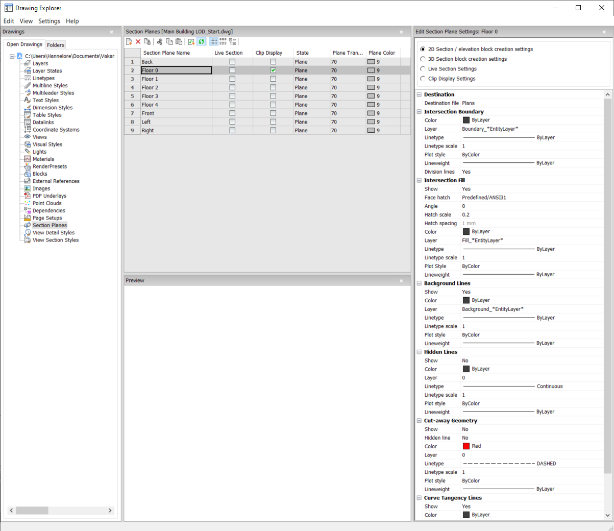

SECTIONPLANESETTINGS command
Opens the Drawing Explorer dialog box with Section Planes category selected.
Methods
Open the Drawing explorer dialog box with Section Planes category selected to view and modify section planes in the current drawing.
Options within the command
- Section Types
- 2D Section/elevation block creation settings
- Specifies properties for 2D sections and elevations. These properties are assigned to the 2D section you create as a block.
- 3D section block creation settings
- Specifies properties for 3D sections. These properties are assigned to the 3D section you create as a block.
- Live Section Settings
- Specifies properties for live sections. With live sections, the entities in the drawing are temporarily modified and viewable in the drawing.
- Clip Display Settings
- When using the clip display status, the display of entities is clipped. The status can be set for multiple section entities simultaneously.

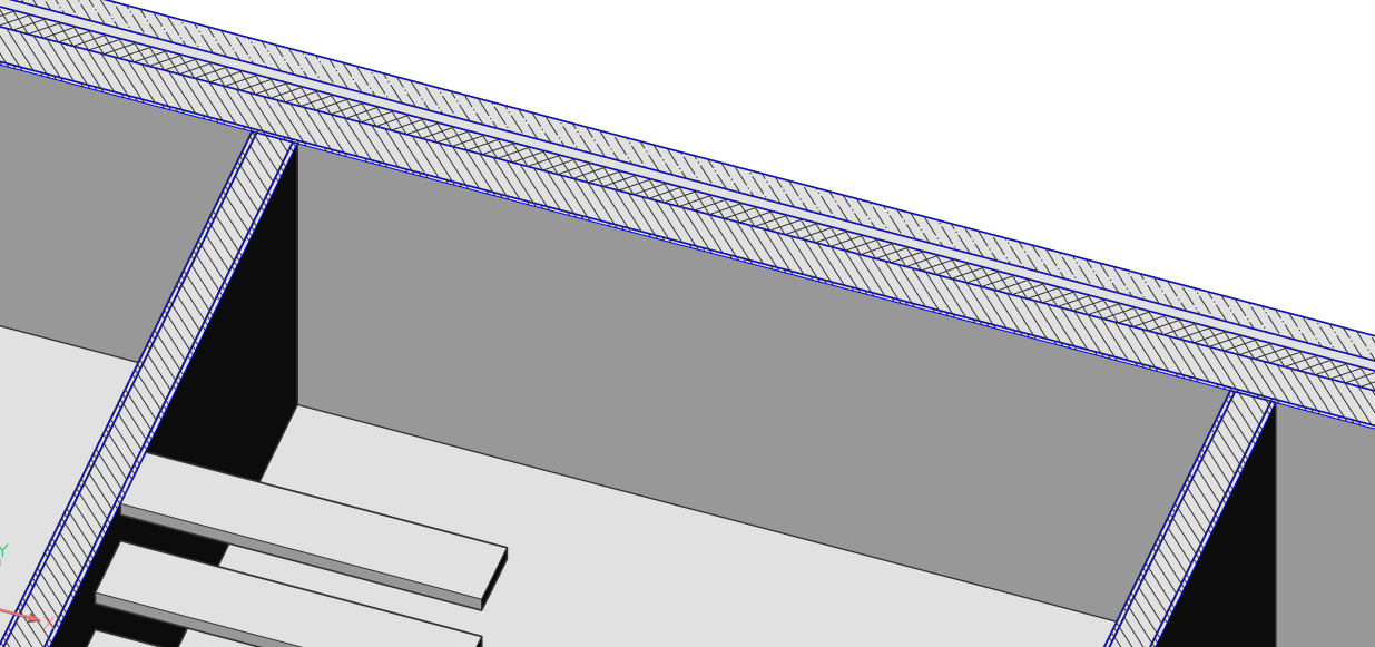

- Show (option available for the 3D sections)
Specifies whether the intersection boundary is drawn.
- Yes: the intersection boundary is displayed. The intersection boundaries are indicated in blue.
- No: no intersection boundary is displayed.Note: The intersection boundary is still visible, since the lines are also drawn for the intersection fill. The color is now determined by the intersection fill instead of by the intersection boundary.
