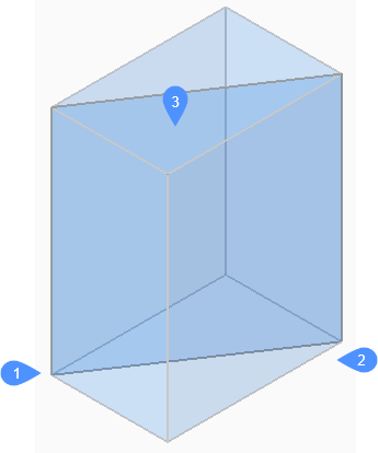

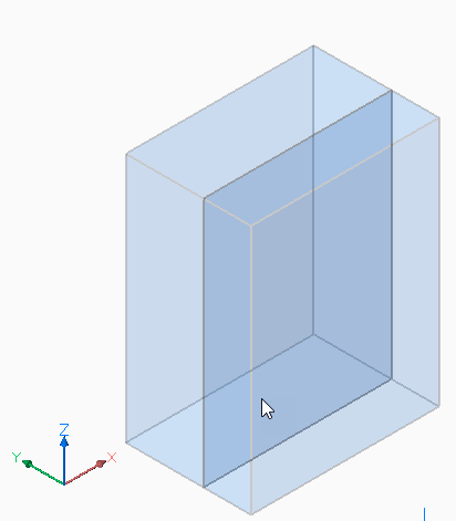

Select one or more 3D solids or surfaces to slice.
Specify the first (1) and the second (2) point on the slicing plane. A dotted line from the first point is displayed to easily visualize the cutting plane. The section plane is perpendicular to the XY-plane of the World coordinate system (WCS).
Then, specify a point (3) on the side of the entity you want to keep or choose to keep both.
Note:
- This command does not work with 2D regions.
- Ensure that the Select faces option of the SELECTIONMODES system variable is activated to be able to use a planar 3D solid as the slicing plane.
- When the ORTHOMODE system variable is On, you can create straight cutting planes.
- The sliced entities can be manipulated as independent entities.

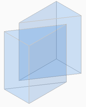

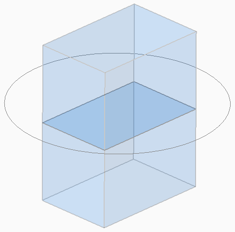

- Entity
- Slices solids and surfaces with an intersecting entity (circle, ellipse, arc, 2D-spline, 2D-polyline, planar 3D solid face, planar surface face, or planar region). The entity defines the plane that slices the 3D selected entities.

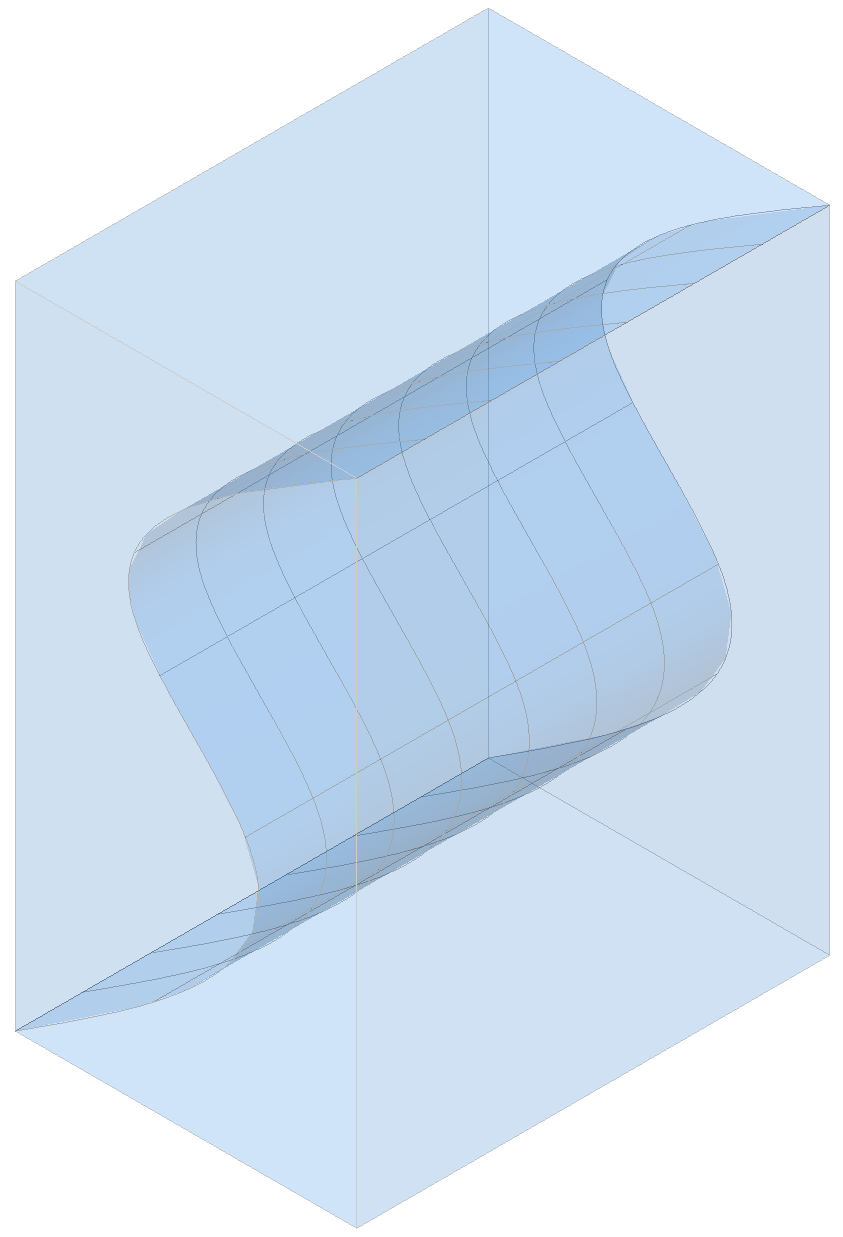

- Surface
- Slices solids and surfaces with a surface.

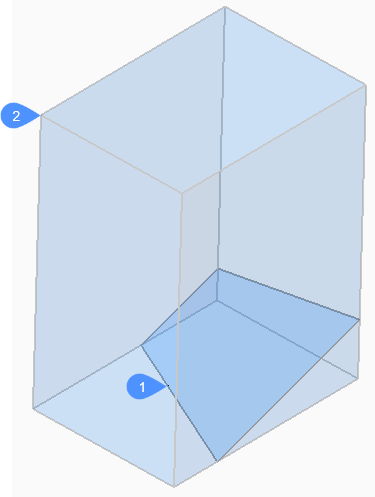

- Zaxis
- Slices solids and surfaces with a plane perpendicular with a line defined by one point on the plane (1), and a second point on the plane's normal axis (z axis) (2).

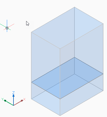

- XY
- Slices solids and surfaces with a plane parallel to the XY-plane of the current coordinate system.

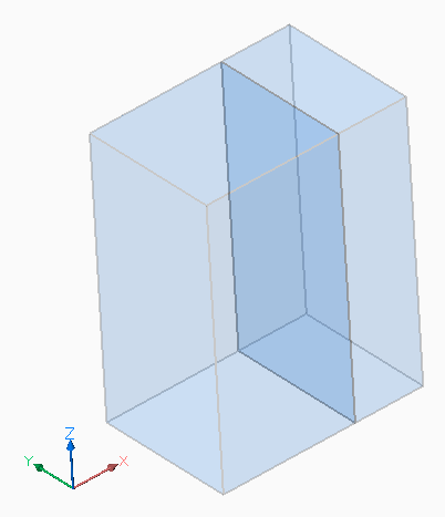

- YZ
- Slices solids and surfaces with a plane parallel to the YZ-plane of the current coordinate system.
- ZX
- Slices solids and surfaces with a plane parallel to the ZX-plane of the current coordinate system.

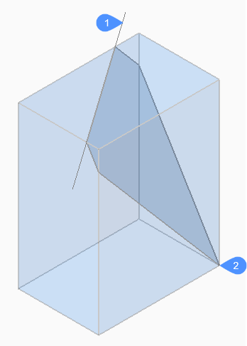

- Line-point
- Slices solids and surfaces with a plane defined by a linear entity (1) and a point (2).

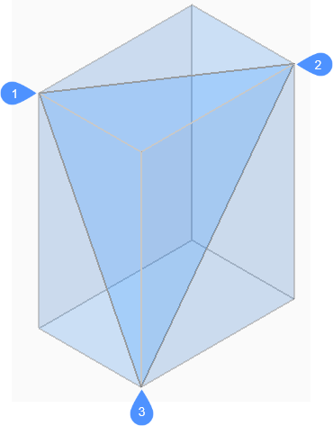

- 3points
- Slices solids and surfaces with a plane defined by three points.

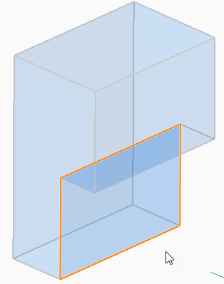

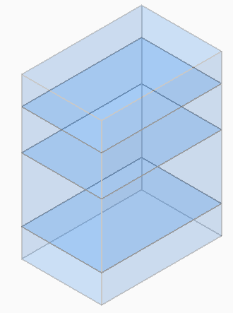

- Multislice
- Slices solids and surfaces in more than one piece using a face and specifying the distance between slices.
