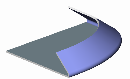

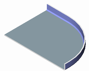

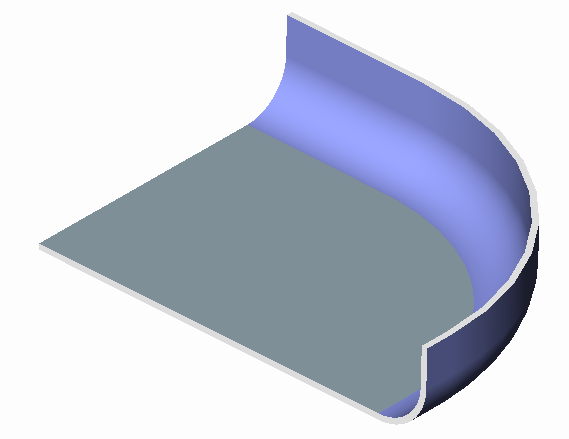

SMROLLEDEDGE command
Creates rolled edges on curved flanges.
Method
Select the edges on flanges or the flange face (entire flange's side) and specify the length of the rolled edge.
Note: The RolledEdge is not created on edges adjacent to Bend, Jog, BendRelief, CornerRelief.
When Dynamic Input Mode (DYN) is active, type the length in the dynamic input fields.
Option within the command
- Angle
- Specifies the angle of the rolled edge. The default value is 90 degrees.
- Radius
- Specifies the radius of the rolled edge. The default value is the thickness of the flange.
