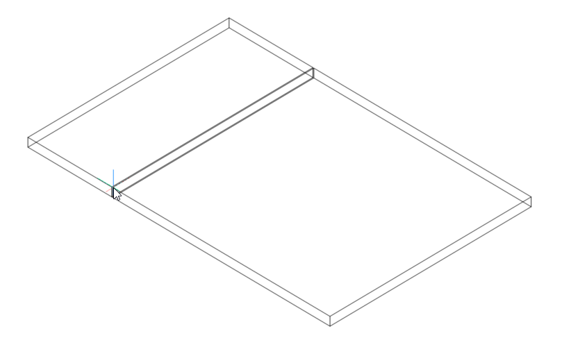

Splits a flange along a polyline drawn along a face. It splits lofted bends along the line on the ruled surface. (Short for Sheet Metal Split).
Options within the command
- Select lines or edges to split the flange
- Splits the flange according to a selected line or edge.
- Center
- Splits along the center of the polyline.
- Left
- Splits to the left side of the polyline.
- Right
- Splits to the right side of the polyline.

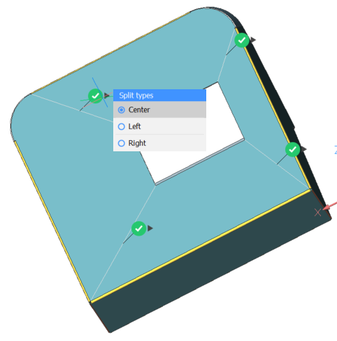

- Accept
- Accepts the suggested way to split.
- SMart split
- Splits the flange at a specified point.

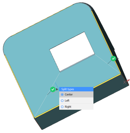

- Flange propagate
- Detects all possible splits for the selected flange.
- vertex Propagate
- Detects all vertices on the flange and applies splits.
Note: The multiple splits suggestions are marked as follows:
: Selected suggestion. Click to switch to not selected.
: Not selected suggestion. Click to switch to selected.

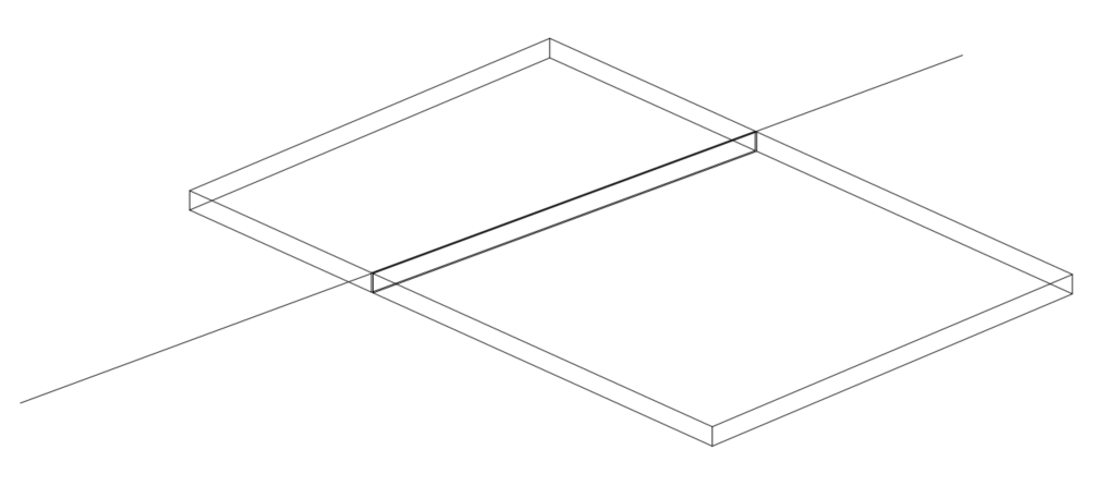

- draw a New line
- Gives the option to draw a line on a selected flange to split the flange.
