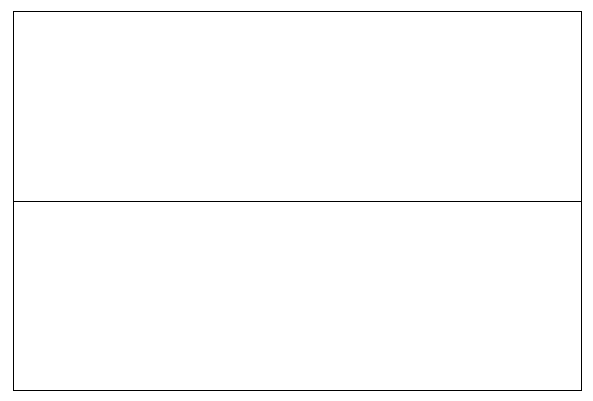

Horizontal
Creates two horizontal viewports, one above another.

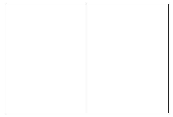

Vertical
Creates two vertical viewports, one beside another.

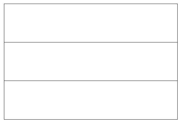

Horizontal
Creates three horizontal viewports, one above another.

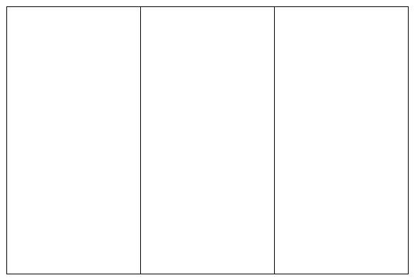

Vertical
Creates three vertical viewports, one beside another.

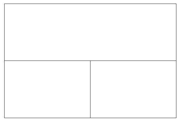

Above
Creates a single wide viewport above two side-by-side viewports.

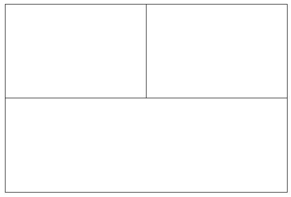

Below
Creates two side-by-side viewports above one wide viewport.

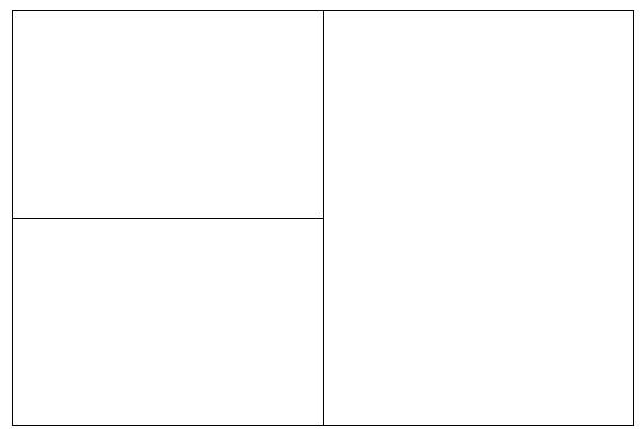

Left
Creates one tall viewport to the left of two stacked viewports.

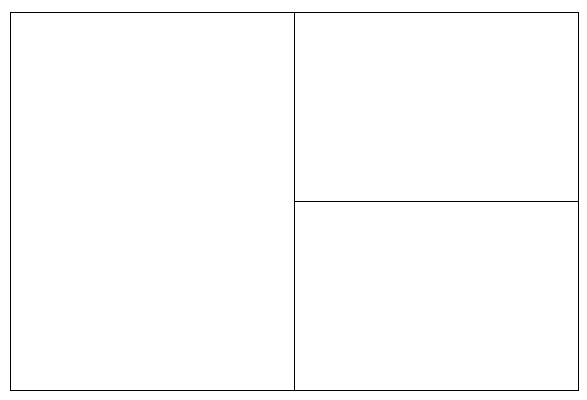

Right
Creates one tall viewport to the right of two stacked viewports.

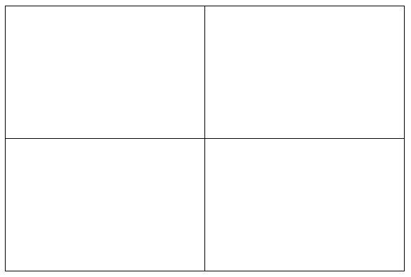

Create 4 viewports
Splits the current viewport into four rectangular viewports.
Note: This style is sometimes called "engineering" viewports, as it allows you to see the top, front, side, and isometric views at the same time, once you adjust the viewpoint in each viewport, which can be done with the MVSETUP command.
Note: Viewports can be resized by dragging their borders.
