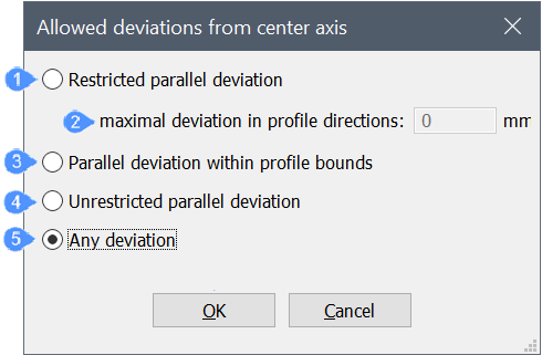

Allowed deviations from center axis dialog box
Opens via: BIMANALYTICALMODEL command
The Allowed deviation from center axis dialog box allows you to set the level of freedom used when generating an analytical model.
- Restricted parallel deviation
- Maximal deviation in profile directions
- Parallel deviation within profile bounds
- Unrestricted parallel deviation
- Any deviation

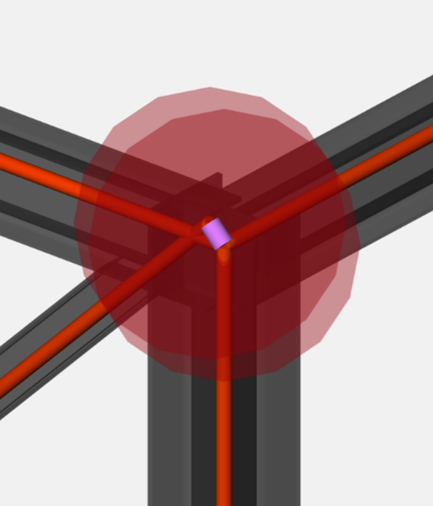

Maximum deviation in profile directions: 0mm

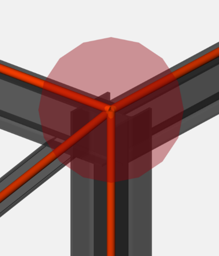

Maximum deviation in profile directions: 20mm
