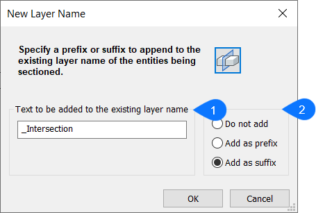

New Layer Name dialog box
Opens via: Drawing explorer dialog box (SECTIONPLANESETTINGS command)
The New Layer Name dialog box allows you to specify the text which is added to the name of the layer when new layers are created as a copy from the existing layer for section planes.
- Text to be added to the existing layer name
- Manner to add the text
Specifies the text that will be added to the existing layer name.
- Do not add
- No text will be added to name of the layer when a copy is created.
- Add as prefix
- The specified text will be added as a prefix to the existing name.
- Add as suffix
- The specified text will be added as a suffix to the existing name.
