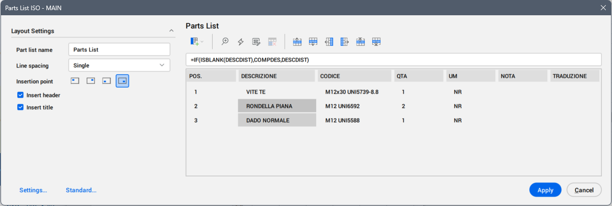

Parts List dialog box
Opens via: AMPARTLIST command
Defines part reference information that appears in the parts list and the layout of the parts list.

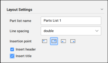

Layout Settings
Defines the layout for the parts list.
Part list name
Defines and displays the part list name.
Line spacing
Defines the line spacing type by choosing one option from the drop-down list.
Insertion point
Defines the placement of the insertion point and the vertical direction of the parts list. If the insertion point is at the bottom, both the header and title points are at the bottom of the parts list, and the parts are listed from bottom to top. Similarly, if the insertion point is at the top, both the header and title appear at the top of the parts list, and the parts are listed from top to bottom.
Insert header
Defines a header for the list.
Insert title
Defines a title for the list.
Settings...
Opens the Parts List Settings dialog box. See the Parts List Settings dialog box article for more information.
Standard...
Opens the Standard Settings dialog box. See the Standard Settings dialog box article for more information.

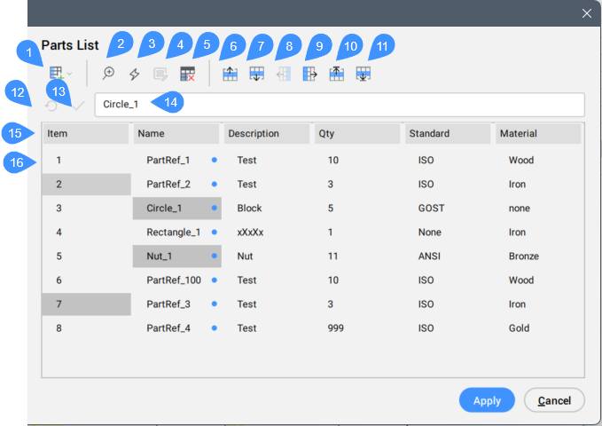

Parts List
  1. Manage columns
  2. Zoom and Highlight
  3. Highlight
  4. Set value
  5. Remove overrides
  6. Move up
  7. Move down
  8. Move left
  9. Move right
  10. Move to the top
  11. Move to the bottom
  12. Cancel the edits made on the formula bar
  13. Saves the edits made on the formula bar
  14. Formula bar
  15. Part references properties
  16. List of the part references
Manage columns
Manages the columns. When you open the drop down list the available options are:
Insert column left
Inserts the chosen column to the left side of the current column. The Select columns dialog box opens.
Insert column right
Inserts the chosen column to the right of the current column.
Remove column
Removes the current column.
Note:
  • The available columns are managed within the BOM Settings dialog box.
  • The Select columns dialog box displays only those columns that have not been inserted yet.
Zoom and Highlight
Zooms and highlights the entities associated with the selected row. It also responds to multiple selected rows or when no row is selected.
When nothing is selected or multiple rows are selected, two options are available to cycle through the results.
Note: If nothing is selected, zooming and highlighting start at the top of the part list and continue downward.
Next item
Cycles through the rows.
next Instance
Cycles through the instances, starting from the first instance of the group.
Highlight
Highlights the entities associated with the selected row. It also responds to multiple selected rows or when no row is selected.

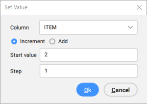

Set value
Overrides the values generated by formulas on the selected cells. The Set Value dialog box opens.
Note: The override values are marked with a blue dot on the right.
Column
Selects the column using the drop down list.
Increment mode
Overrides cell values using a sequence defined by the Start value and Step.
Add mode
Overrides cell values by adding the specified Value to the current one.
Note:
  • Not all columns accept overridden values.
  • The overridden values are highlighted in blue color.
Start value
Defines the start value for incremental mode for overriding the cell value.
Step
Defines the step value for incremental mode for overriding the cell value.
Value
Defines the value to be added to the existing value of the cell.
Remove overrides
Removes overrides from the current selection and restores their default values as calculated by their formula.
Note: This button is available only when overrides exist within the current selection.
Move up
Moves the row of the selected cell one step up in the parts list. Multiple rows can be moved at once, too.
Move down
Moves the row of the selected cell one step down in the parts list. Multiple rows can be moved at once, too.
Move left
Moves the column of the selected cell one step to the left in the parts list. Multiple columns can be moved at once, too.
Move right
Moves the column of the selected cell one step to the right in the parts list. Multiple columns can be moved at once, too.
Move to the top
Moves the row of the selected cell to the top of the parts list. Multiple rows can be moved at once, too.
Move to the bottom
Moves the row of the selected cell to the bottom of the parts list. Multiple rows can be moved at once, too.
Cancels the edits made on the formula bar.
Saves the edits made on the formula bar.
Formula bar
Allows you to introduce or view a formula. The new value is saved when you press ENTER.
Displays the property names of parts references marked as visible in the BOM Settings dialog box that define the header of the Parts List table. The names of these properties are defined in the Caption field of the BOM Settings dialog box.
Lists the parts references included in the chosen BOM.
