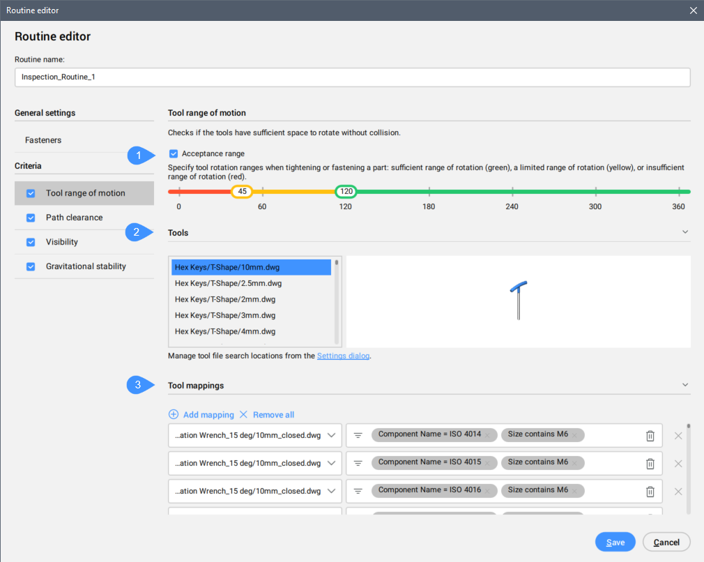

Routine editor dialog box
Opens via: Manage Routines (BMASSEMBLYINSPECT) dialog box
The Routine editor dialog box allows you to create criteria that will be taken in consideration in Assembly Inspect tool.

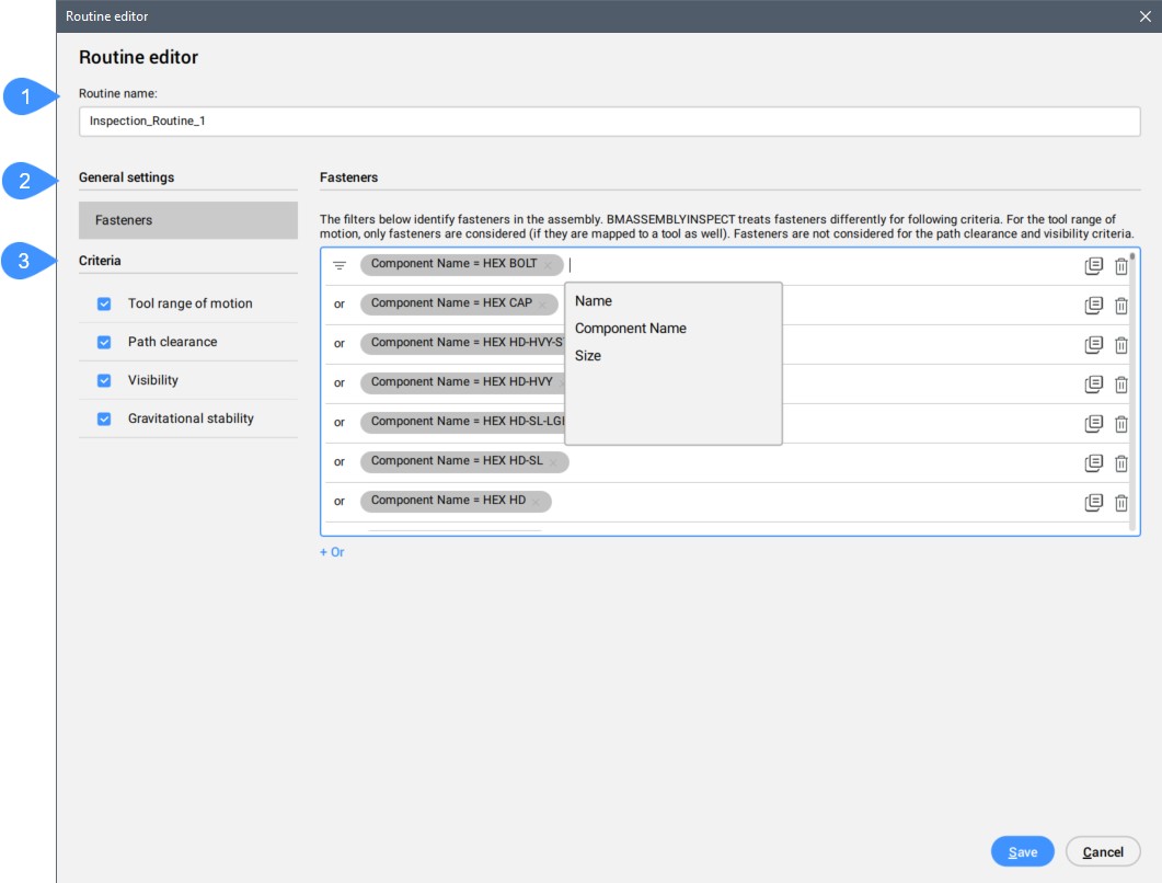

  1. Routine name
  2. General settings
  3. Criteria
Routine name
Specifies the profile name under which the rules are grouped.
General settings
Allows you to create a Fasteners pre-configuration tools.
Fasteners
Defines filters for identifying fasteners in the assembly. The BMASSEMBLYINSPECT command treats fasteners differently for following criteria. For the tool range of motion, only fasteners are considered (if they are mapped to a tool as well). Fasteners are not considered for the path clearance and visibility criteria.

Tool range of motion
  1. Acceptance range
  2. Tools
  3. Tool mappings
Evaluates whether tools have sufficient maneuverability space. For example, whether each fasteners have enough space to be handled with the specific tool.
Acceptance range
Specifies the tool rotation ranges when tightening or fastening a part: sufficient range of rotation (green), a limited range of rotation (yellow), or insufficient range of rotation (red).
Tools
Lists the available tools (a range of standard hex keys and one screwdriver) stored in the installation folder C:\Program Files\Bricsys\BricsCAD V27 en_US\UserDataCache\Support\en_US\DesignLibrary\Tools which are loaded automatically as tools.
Note: Those hand tools can be accessed also from the Library panel.
The BMTOOLPATH system variable indicates the file paths used to search for tool files. You can also manage the search locations of the tool files by pressing the Setting dialog button.
Tool mappings
Allows you to define multiple tool-fastener mappings in order to evaluate multiple tools per fastener.
Add mappings
Allows you to add mappings.
Remove all
Removes all mappings.

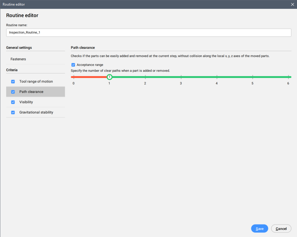

Path clearance
Evaluates whether each part or fastener can be easily added and removed in the current step without collision along the directions of the six local coordinate axes, called the X, Y, and Z "local axes".
Acceptance range
Specify the clearance ranges when a part is added or removed: the path is clear of obstacles (green), the path is partially restricted (yellow), or the path is blocked (red).

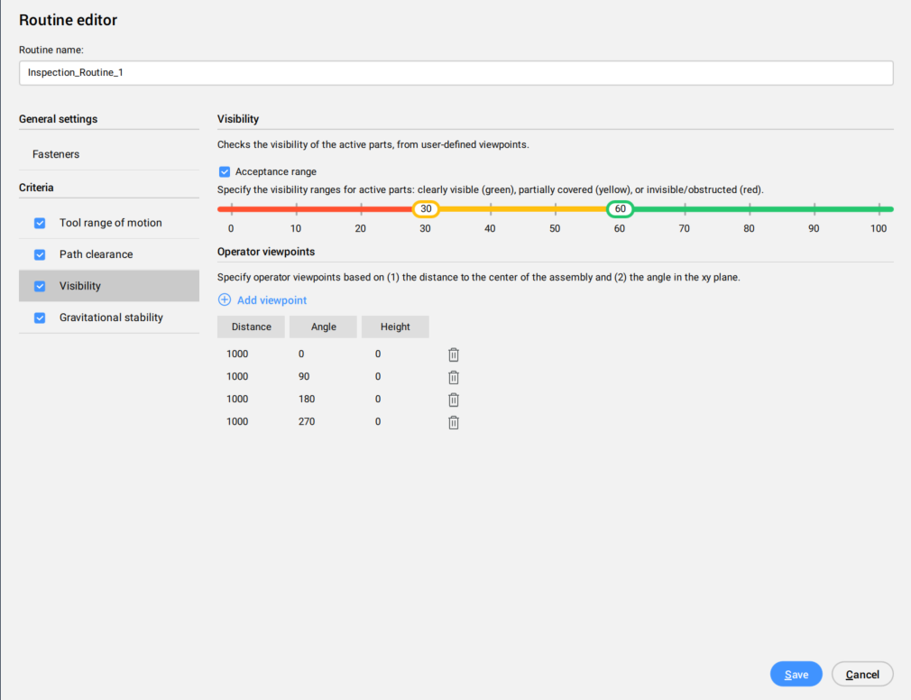

Visibility
Evaluates the visibility of the active parts from the user-defined viewpoints. The operator viewpoints are defined by the distance to the center of the assembly and the angle in the XY plane.
Acceptance range
Allows you to specify the visibility ranges for active parts: clear visible (green), partially covered (yellow), or invisible/obstructed (red).
Add viewpoint
Adds viewpoint for visibility check.

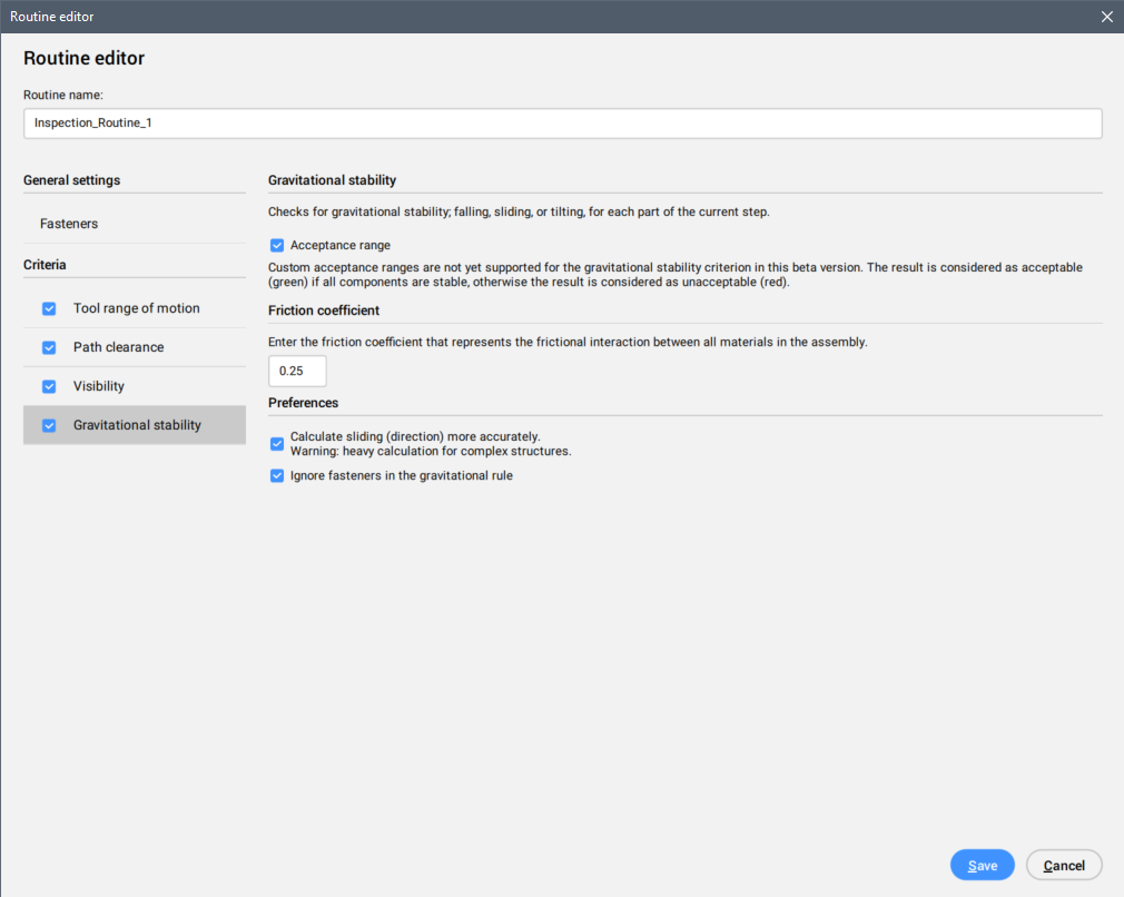

Gravitational stability
Evaluates the gravitational stability for each part of the current step in three ways: falling, sliding, and tilting. If parts are falling, sliding and tilting is not considered anymore. Partial results for the three checks are shown, as well as temporary arrows in model space. All parts of a step are considered separately, both in the calculation and in the presentation of the results.
