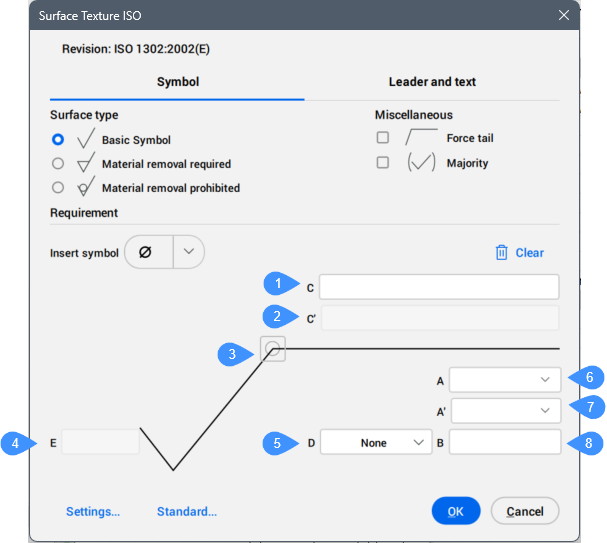

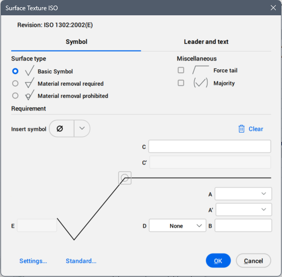

Symbol
Specifies the surface texture characteristics. The available characteristics depend on the chosen drafting standard, ISO, DIN, ANSI, or JIS.
- Surface type
- Allows you to choose one of the following surface types: Basic symbol, Material removal required, or Material removal prohibited.
- Miscellaneous
- Indicates which surface texture symbols are available for using.
- Force tail: shows the state of other surface texture symbols elsewhere in the drawing in parenthesis at the right side of the collective indication.
- Majority: shows the collective indication (that is a symbol common to all surfaces textures). This option is not available for the ANSI drafting standard.
- Requirement
- Defines the parameters of the surfaces textures.
- Insert symbol
- Inserts a symbol from the drop down list into the selected parameter field.
- Clear
- Clears the last inserted parameters. The cells will become empty.
- (1) Process note 1
- Defines the process requirements for the surface.
- (2) Process note 2
- Defines the process requirements for the surface. This option is not available for the drafting JIS and ANSI standards.
- (3) All around
- Toggles the visibility of the All Around symbol.
- (4) Machine allowance
- Specifies the machining allowance for the surface.
- (5) Direction of lay
- Sets the direction of lay for the surface.
- (6) First requirement
- Defines the first requirement for the surface.
- (7) Second requirement
- Defines the second requirement for the surface.
- (8) Third requirement
- Defines the third requirement for the surface.

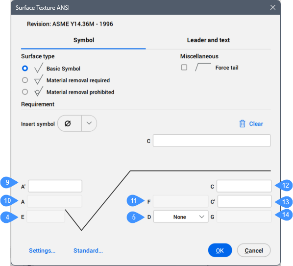

Some more requirements are available only for ANSI drafting standard.
- Additional Requirements:
- (9) Roughness average max
- Defines the maximum roughness average for the surface.
- (10) Roughness average min
- Defines the minimum roughness average for the surface.
- (11) Cutoff
- Defines the cutoff value for the surface.
- (12) Sampling length
- Defines the sampling length required for the surface.
- (13) Other roughness max
- Defines the maximum other roughness for the surface.
- (14) Other roughness min
- Defines the minimum other roughness for the surface.

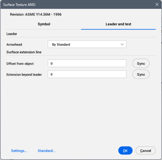

Leader and text
Specifies the Leader and text characteristics.
- Leader
- Sets the leader properties.
- Arrowhead
- Defines the default leader arrowhead type from the drop down list.
- Surface extension line
- Sets the surface extension line properties.
- Offset from object
- Defines the distance between the extension line’s start point and the attached object.
- Extension beyond leader
- Defines the distance between the symbol’s start point and the surface extension line’s end point.
