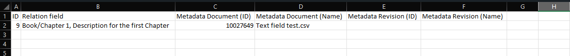

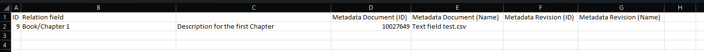

    • For the Relation field, you also need two columns: one for the Name and one for the Description.
      The Description column of the Relation field should be added manually in the CSV file. The Description for the Relation item can be found in the Name column after the comma. In the Relation field, it is required to have only the path to the chosen item (without description and comma).
    Before:
    After:
