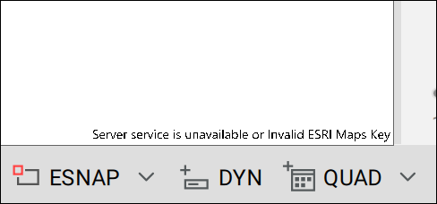

Symptoms
When trying to use an ESRI Map, I get the "Server service is unavailable or Invalid ESRI Maps Key" error message in the lower right corner of the screen.

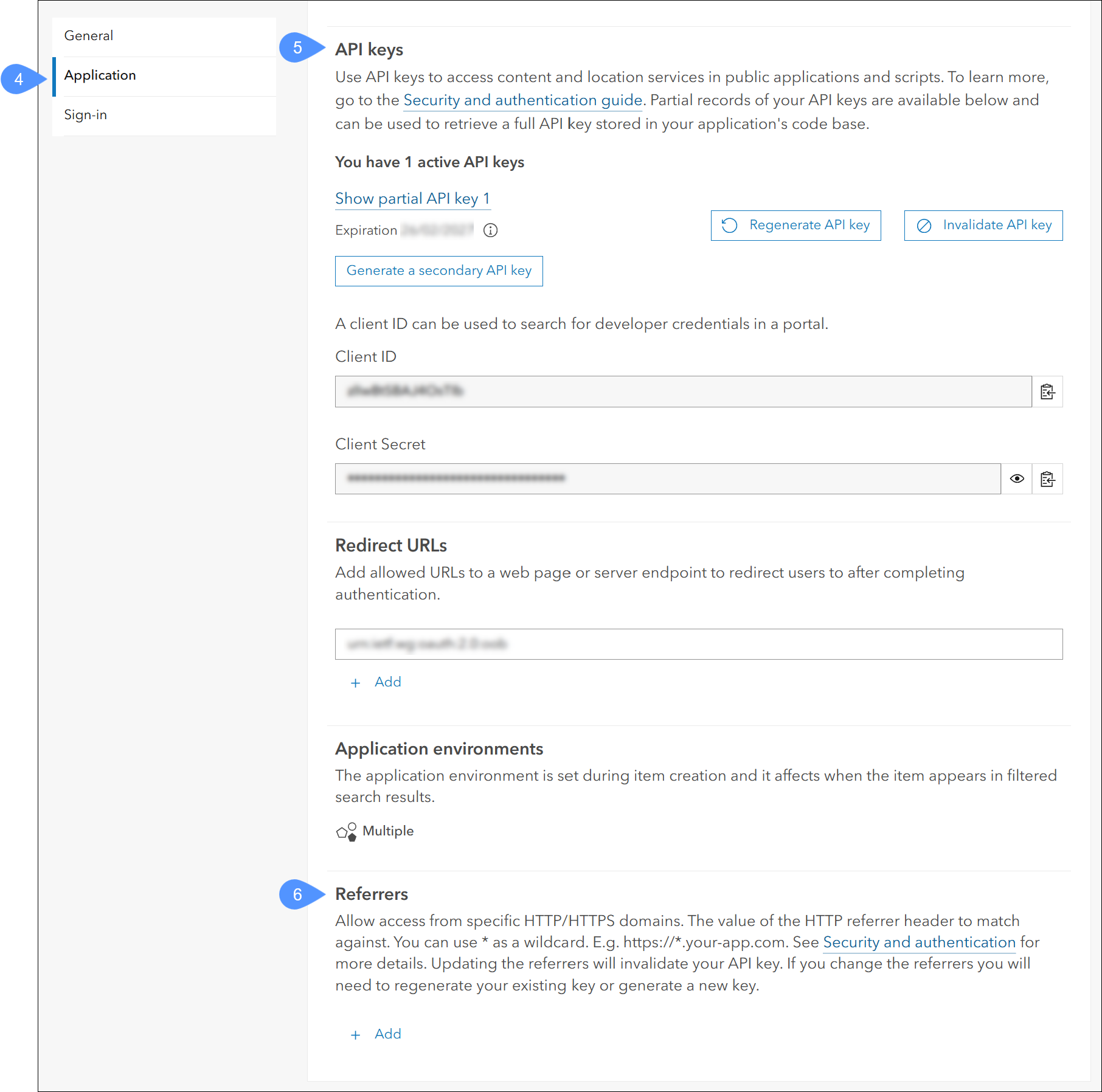

    To see if your API key has expired, you need to access your API key credentials. If your key is expired, you can generate a new one.
  • When your API key has referrer URLs
    To see if your API key has referrer URLs, you need to access your API key credentials. If any entries are listed, they should be deleted.
    Note: Updating the referrers invalidates your API key. If you change the referrers, you also need to regenerate your existing key or generate a new one.

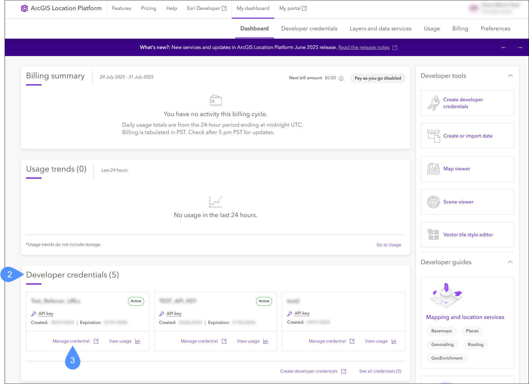

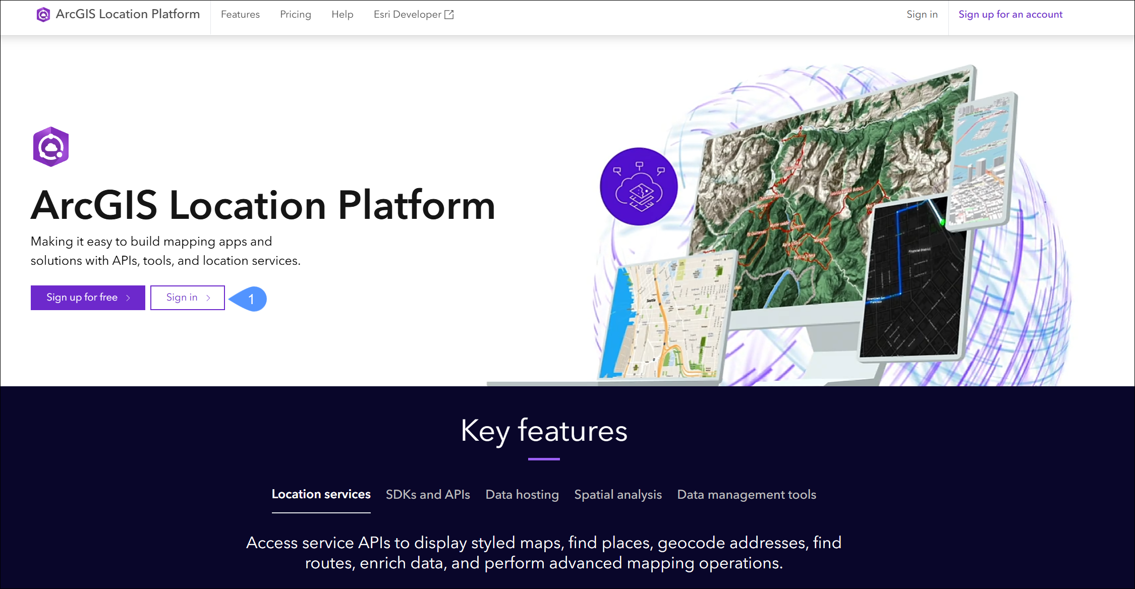

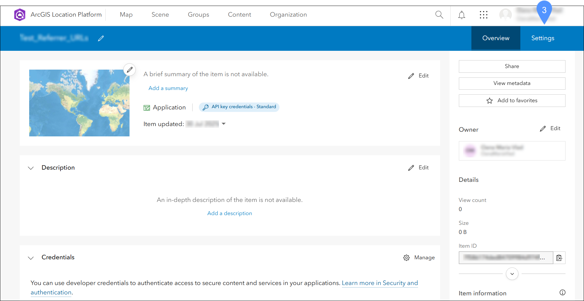

  1. Sign in to your account at ArcGIS Location Platform. Click the Sign in button (1).

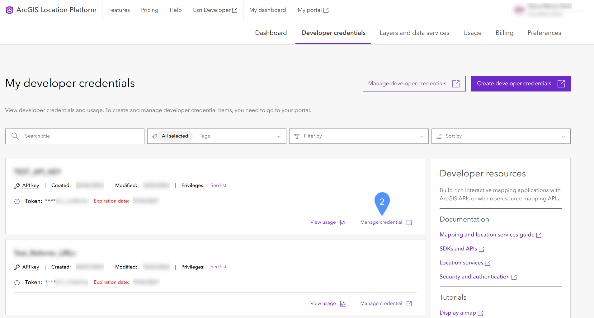

  2. Once you have signed in, on the ArcGIS Location Platform > My dashboard, go to the Developer credentials tab. Choose the relevant API key and click Manage credential (2).

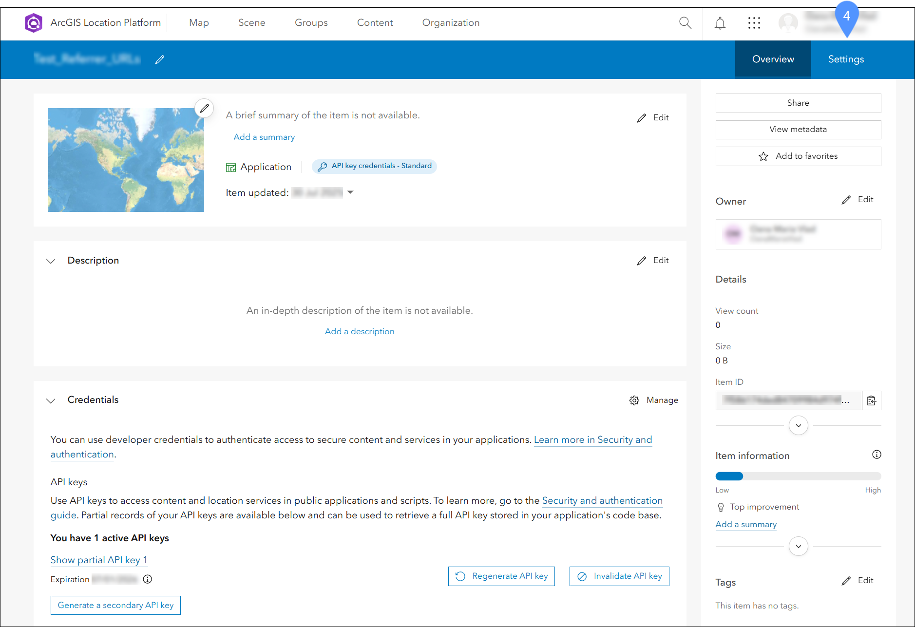

  3. A new browser tab with the API key Overview opens. Select Settings (3) at the top right of the page.
  4. You can now view or modify your API key settings.
    Go to Application(4) tab and scroll down to API keys (5) to check the expiration date or to Referrers (6) to see if there are listed entries.
