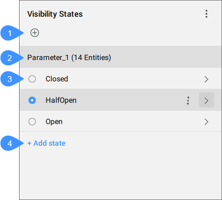

The Visibility States panel displays the visibility parameters found in the drawing and their corresponding visibility states.
  1. Add parameter
  2. Parameter's name
  3. List of parameter's visibility states
  4. Add state
Add parameter
Adds a new parameter to the block.
Note: The new created parameters appear in the Parameters section in the Properties panel.
Parameter's name
Double-click to edit the parameter's name.
List of parameter visibility states
Lists all the parameter's visibility states. Double-click a state name or click the right-side arrow to access its entities.
Add state
Adds a new visibility state to the parameter. If the parameter already has states with entities assigned, all these entities will, by default, be invisible for the new state.

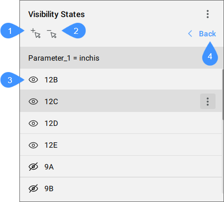

State entities
After selecting a visibility state, the panel shows the list of entities assigned to that state.
  1. Add entities
  2. Remove entities
  3. List of entities
  4. Back button
Add entities
Allows you to select entities in the drawing and add them to this parameter.
Entities that are not in the parameter are added and made visible only for the selected state, and invisible for all other states. Entities that are already in the parameter are made not affected.
Remove entities
Allows you to select entities in the drawing and remove them from this parameter and all its states.
Note: If entities are already selected before adding or removing them, the actions apply on the already selected entities.
List of entities
Lists all the entities that belong to the selected visibility state, along with an icon that indicates the visibility of each of these entities.
Note: One entity can be assigned to multiple parameters at the same time. In this case, the entities will only be visible if they are set to be visible for the current states of both parameters.
If you select one or more entities, then click one entity's 'eye' icon, its visibility is switched (from visible to invisible or vice versa). The new visibility also applies to all other selected entities.
Note: If multiple entities were selected and the eye icon was clicked for one entity that is currently invisible, all selected entities will become visible.
Whenever there are entities that are (in)visible for all states of a parameter, a message label will appear at the bottom of the main view of the panel, together with two link buttons. Show will highlight these entities in red and, if they are invisible, make them visible and semi-transparent. Remove from Parameter will remove these entities from the appropriate parameters, making them visible but no longer linked to the parameter.
The selection of entities in the panel changes the selection in the drawing, and vice versa. This allows you to easily check which entities are visible or invisible in the current state.
Back button
Takes you back to the main view of the panel.
