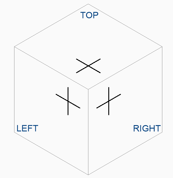

Controls the current viewport's isometric plane (left, top or right), if the SNAPSTYL system variable is set to isometric.
Press F5 function key to set the appropriate drawing plane: Left, Top or Right.

0: Left 1: Top 2: Right |
