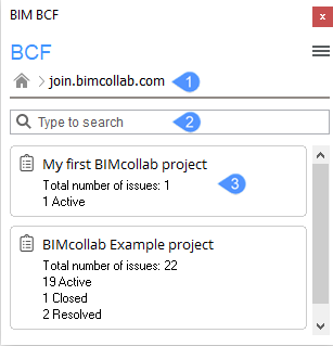

- Source URL
- Search
- Project list
- Source URL
- Displays the source URL.
- Search
- Displays only the projects filtered by the word you type in the search bar.
- Project list
- Displays the list of projects that you are involved in.
Project list

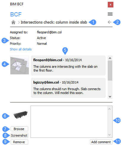

After you left-click the project will open it and show a list of the issues. When you left-click on an issue, this dialog box will open.
- Issue name
- Issue overview
- Details
- Thumbnail image
- Comments
- Preview
- Browse
- Screenshot
- Remove
- Comment
- Add comment
- Issue name
- Displays the name of the opened issue.
- Issue overview
- Returns you to the issue overview.
- Details
- Displays detailed information about the issue, such as status, author and creation date.
- Thumbnail image
If the comment has an associated camera position, then clicking the thumbnail image will take the camera in the current drawing to this position.
This is useful if you want to know where exactly the issue is, and you do not want to manually search through the model.
- Comments
- Displays the comments on the issue.
- Preview
- Displays a preview of the issue after you press the button no. 8.
- Browse
- Opens the Select a viewpoint for this comment dialog box.
- Screenshot
- Insert a screenshot from model space in the preview field (no. 6).
- Remove
- Removes the screenshot preview.
- Comment
- Allows you to insert a comment for an issue.
- Add comment
- Adds the comment you have inserted in field no. 10 to an existing issue.
