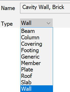

- Choose a Composition Type from the drop-down menu and press Select to accept.

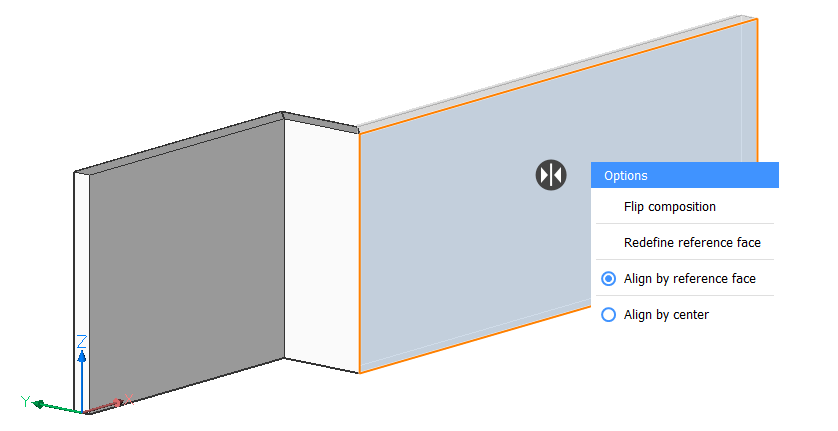

- Choose the reference face. If you hover over the widget, a submenu displays showing different options. For more information about how to redefine the reference face, see BIMATTACHCOMPOSITION.
- Press Enter to accept the reference face.

- A widget appears that allows you to choose the reference face.The reference face is fixed, while the opposite face moves if the thickness of the composition does not fit the current thickness of the solid.
- A darker volume indicates the volume and position of the solid after attaching the composition.
- Press Enter to accept the current reference face and attach the composition.

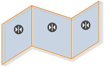

- Select the solids you want to apply the composition to.
- Select the composition in the BIM Compositions panel.
- Hold down the left mouse button and drag the composition on any of the selected solids.
- Release the left mouse button to attach the composition.A widget appears which allows you to choose the reference face for every segment separately.
