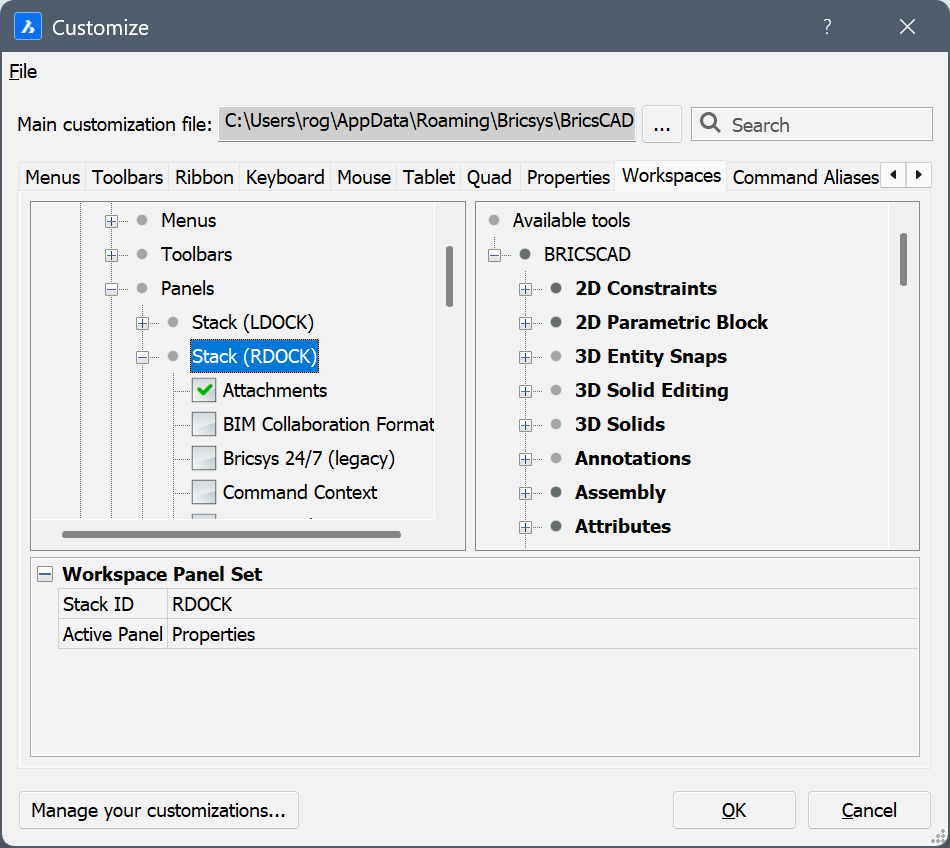

By default, panels are docked at the left or right side of the screen as defined in the Panels node of a workspace in the Workspaces tab of the Customize dialog box:
  • Panels > Stack (LDOCK) selects the panels stacked at the left side of the screen.
  • Panels > Stack (RDOCK) selects the panels stacked at the right side of the screen.
The stack type is defined in the Workspaces tab of the Customize dialog box through the Stack Panel Type property of a workspace.

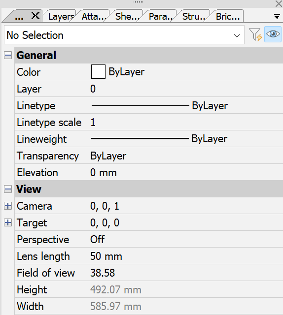

Dockable stack with tabs (STACKPANELTYPE = 0)
Panels are docked in a tabbed panel.
  • Click a tab to display the panel.
  • To change a tab's position, click and drag the tab to the new position.
  • Double click a tab to make the panel floating.
  • Double click the title bar of a floating panel to dock it at its previous position.

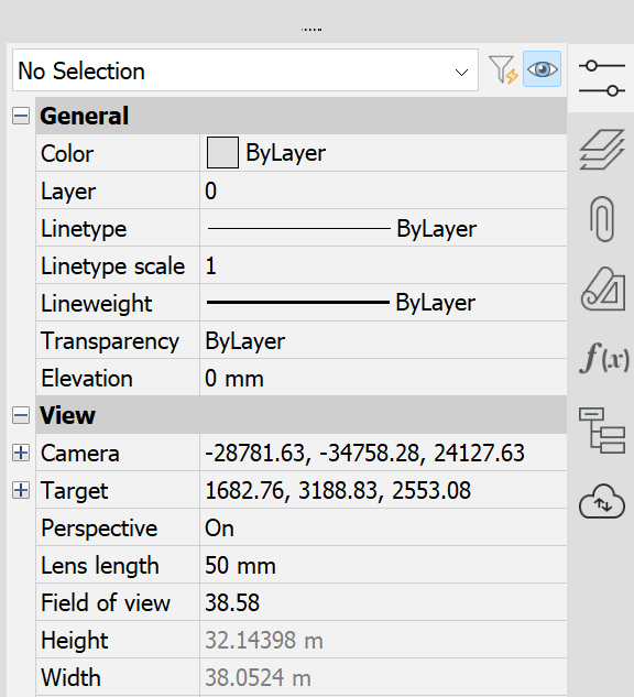

Collapsible stack with icons
Panels are docked in an icon strip at the left and/or right side of the screen.
  • To change an icon's position, click and drag the icon to the new position.
  • Double click the icon to make the panel floating.
Expands over drawing area (STACKPANELTYPE = 1)
Flyout panels overlap the drawing area, so a part of the drawing is hidden.
  • Hover the cursor over a panel icon to expand the panel.
  • Move away the cursor from the expanded panel to collapse it.
  • To turn off (then back on) the auto-collapsing behavior, click the icon of the expanded panel.
Resizes drawing area (STACKPANELTYPE = 2)
Flyout panels narrow the drawing area.
  • Click an icon to expand a panel.
  • Click a different icon in the icon strip to display the corresponding panel.
  • Click the icon of the expanded panel to collapse it.
