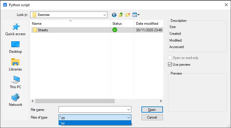

Procedure: executing the Python script
  1. Open a new or a BricsCAD file where you would like to run a Python script.
  2. Type BIMPYTHON in the Command line and press Enter.
  3. A dialog box is displayed where you can only select a Python script file (*.py). Select it and click Open to execute the file.
  4. Unless you have specified the data to be exported or displayed in an external program outside BricsCAD, BricsCAD reports the output in the Command line.
