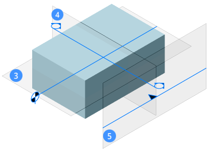

    The template used for creating a section entity depends on the direction of the section plane (horizontal or vertical) and whether it intersects with the model.
    Plan (3) Displays horizontal section plane.
    Section (4) Displays a vertical section that cuts through the model.
    Elevation (5) Displays the exterior elevation view.

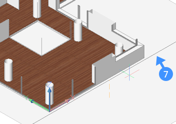

Creating a plan section
Note: A plan section is best defined in the WCS (World Coordinate System).
  1. Choose Define Section in the Model tab of the No Selection Quad.
  2. Place the section tracker near the 3D model and click (6).
    The initial section plane lies in the XY- plane (Z = 0) of the current coordinate system (e.g. the WCS).
    The section plane displays dynamically and the 3D model is clipped accordingly (7).

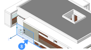

  2. Place the section tracker over a 3D solid face (8) parallel to the cross-section to be defined.

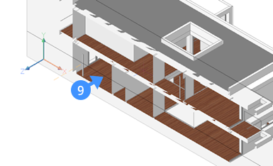

  3. Click when the face highlights and move the section tracker inside the 3D model.
    The section plane displays dynamically and the 3D model is clipped accordingly (9).
    If Dynamic Dimension is On, the current distance displays in a dynamic dimension field.
  4. Click when the section plane is at the desired location or specify a distance.
    The cross-section is defined.

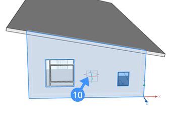

Creating an elevation
Make sure Dynamic UCS (DUCS) is turned on.

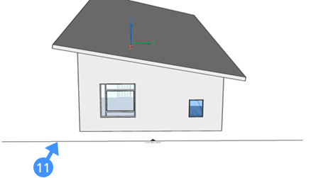

  2. Place the section tracker over a 3D solid face (10) which is parallel to the elevation to be defined and click when face highlights.
  3. Move the section tracker outside the 3D model and click to define the elevation (11).
    Vertical sections outside the model (no geometry is sectioned) get the Elevation section template automatically.

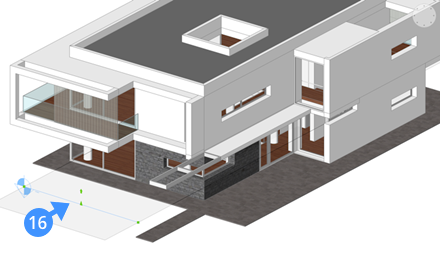

The following illustration shows the 3D model of a villa with a plan section (16) for the ground floor plan:
To clip the 3D model, do one of the following:
  • Double click the section entity.
  • Select Clip display from the Quad.
  • Select the section plane and set the Clip display property to Yes in the Properties panel.
  • When RT (Rollover Tips) is selected in the Status Bar, place the cursor over a section entity to set the Clip display property.

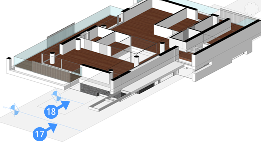

In the following illustration, Clip display is turned On for two BIM section entities (17,18). These section entities are in opposite view directions: section plane 18 is a plan section, section plane 17 is a reflected ceiling section.

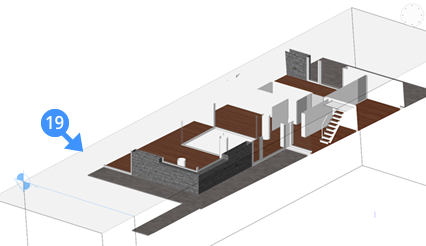

(Optional) Set the Type property for the current section to Volume in the Properties panel.
A clipped section is displayed in the Volume type (19).
