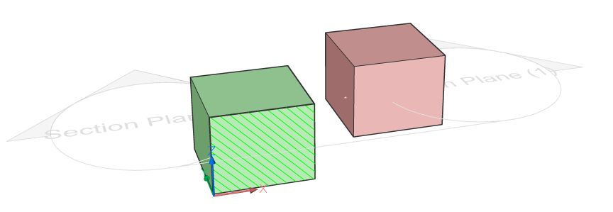

  1. Open the millimeter template BIM-mm.dwt and save the drawing.
  2. Draw two boxes of 500x500x400, one a bit behind the other.
  3. Put the first box on the layer Layer1 (with layer color green) and the second box on the layer Layer2 (with layer color red).

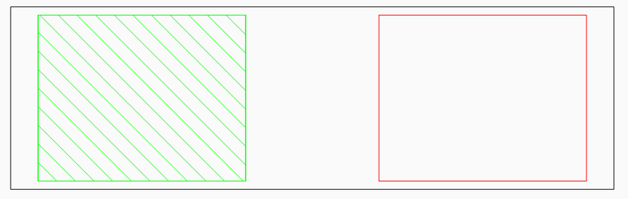

  4. Create a BIM section, aligned with the front face of the first, green box and cutting through it in the middle, but not cutting through the second, red box.
  5. Generate and open the section drawing.

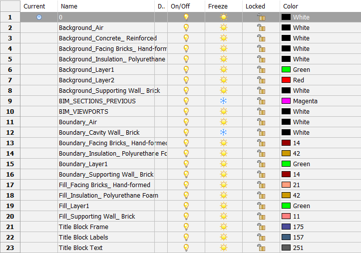

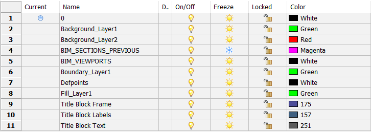

  6. Take a look at the Layers panel.
    Three groups of layers have been created: Background, Boundary, and Fill.
    The generated layers for the green solid are:
    • Boundary_Layer1: the boundary of the section through the box.
    • Fill_Layer1: the hatching of the section.
    • Background_Layer1: shows subentities (for example, vertices of solids) that are not sectioned.
    The layers all inherit the color of the Layer1 layer.
    Since the red solid is not sectioned, only the Background_Layer2 layer is created. It inherits the color of the Layer2 layer.

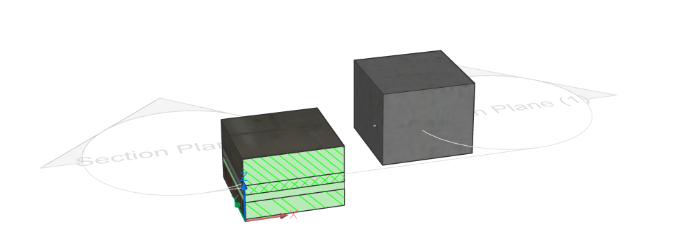

  7. Drag the Cavity Wall, Brick composition from the Compositions panel onto the green box.
    Note:
    • Set the LEVELOFDETAIL system variable to 1 or 2, to display the ply materials.
    • The composition always gets priority when it is assigned to a solid that is placed on a colored layer. This means that the colors set by default for that composition's layers have priority, not the color assigned to the solid's layer.

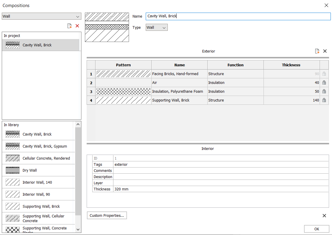

  8. Double-click the Cavity Wall, Brick composition in the Compositions panel.
    This composition consists of 4 plies, each with its own material. A physical material is associated with a hatch pattern, used for floor plans and sections. Another pattern is specified for elevations.
  9. Assign the Concrete, Reinforced composition to the red box.

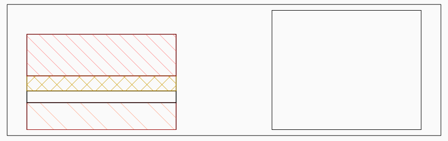

  10. Update and open the section.
  11. Go to your layers and execute the PURGE command to remove the unused layers.
    You see the three categories (Background, Boundary, and Fill) again. The second part of the layer name is the name of the physical material used in the solid, instead of the layer name of the box:
    • Background_Facing Bricks_Hand-formed, Background_Insulation_Polyurethane Foam, and Background_Supporting Wall_Brick.
    • Boundary_Facing Bricks_Hand-formed, Boundary_Insulation_Polyurethane Foam, and Boundary_Supporting Wall_Brick.
    • Fill_Facing Bricks_Hand-formed, Fill_Insulation_Polyurethane Foam, and Fill_Supporting Wall_Brick.
  12. Set the Generate elevation fill property of the section to ON to add an elevation hatch.
  13. Update the section.
  14. The outline of the second box is now hatched and the layer Elevation_Concrete_Reinforced is added.

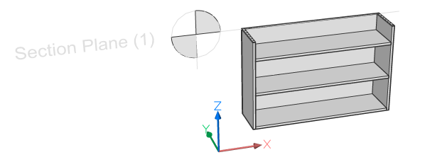

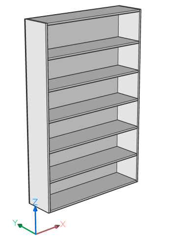

  2. Drag the component Furniture Bookshelf into the drawing. You can find the component in the Furnishing Elements category in the Library panel (LIBRARYPANELOPEN command).

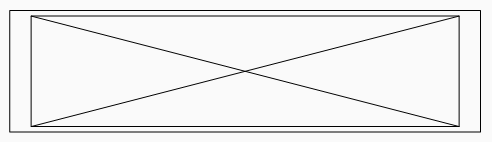

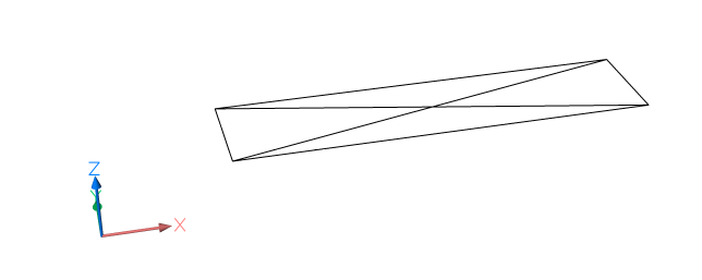

  3. If you now show and isolate the BRX_2D_Symbols layer, you will see a symbol drawn at the insertion point of the bookshelf.
  4. Show all layers again (LAYUNISO command) and make a section through the bookshelf.
  5. Generate and open the Plans drawing.

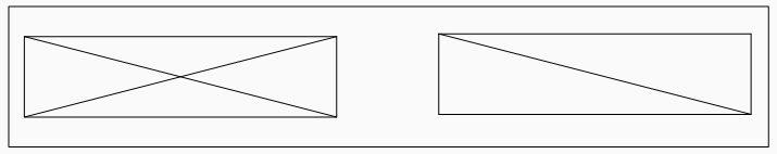

  6. You will see (if the Boundary_BRX_2D_Symbols layer is on) that only the symbol is drawn onto the plan, and not the real section. It happens because this component had a 2D symbol on the BRX_2D layer attached to it.
  7. Now return to your 3D model and open a copy of the bookshelf.
  8. Hide the bookshelf itself and make sure the BRX_2D_Symbols layer is on.
  9. Delete one of the lines (of the cross).
  10. (Optional) Draw extra 2D lines on the BRX_2D_Symbols layer.
  11. Save the drawing.
  12. Go back to the original 3D model and type in BMINSERT in the Command line and go to the file path where you just saved the new bookshelf. Click OK and choose a point to insert the bookshelf.
  13. Regenerate the section and open it. Widen the viewport if necessary by dragging the existing viewport.
  14. The second bookshelf has the adapted symbol displayed.

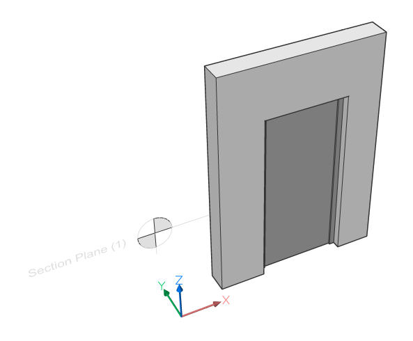

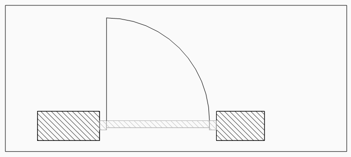

  15. Draw a wall in your 3D model and insert the door Door Ext Plain into this wall.
  16. Repeat steps 3 to 5, but now use the BRX_2D+_Swing layer instead of the BRX_2D_Symbols layer.
  17. The generated plan displays the symbol of the door swing as well as the door section itself. The BRX_2D+ layer of a component makes sure you can show the real section together with a symbol.
    • Symbols on a layer with prefix BRX_2D_ will be used to replace the geometry resulting from the actual section.
    • Symbols on a layer with prefix BRX_2D+_ will be added to the section result. Only those 2D entities in a plane parallel to the section plane are considered.

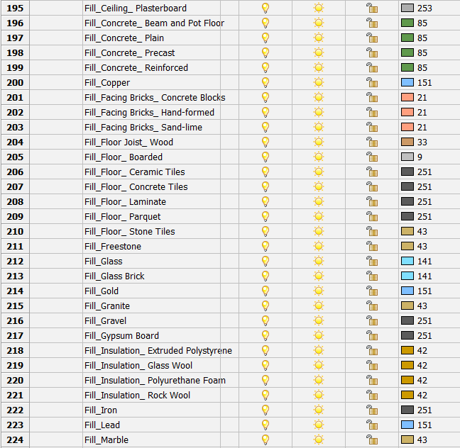

  1. In the above procedure Understanding the created layers, you saw that for objects without a composition, the colors and line weights of the Fill_, Background_, and Boundary_ layers are copied from the layer properties in the 3D model.
  2. However, for objects with a composition, the default colors are set by a template found by typing in SUPPORTFOLDER command and browsing to Bim/Sections/_SectionSettings.dwg.
  3. Open this drawing.
  4. Go to the Layers panel. Here is available a list of all the possible layers that can be created for every material present in the material library. They all have a color and line weight. Changing the color or line weight and saving the file will change the default color or line weight for this layer in your future generated drawings. You can fully customize how your drawing will look for every type of line (Fill, Background, Boundary, or Elevation) per material.

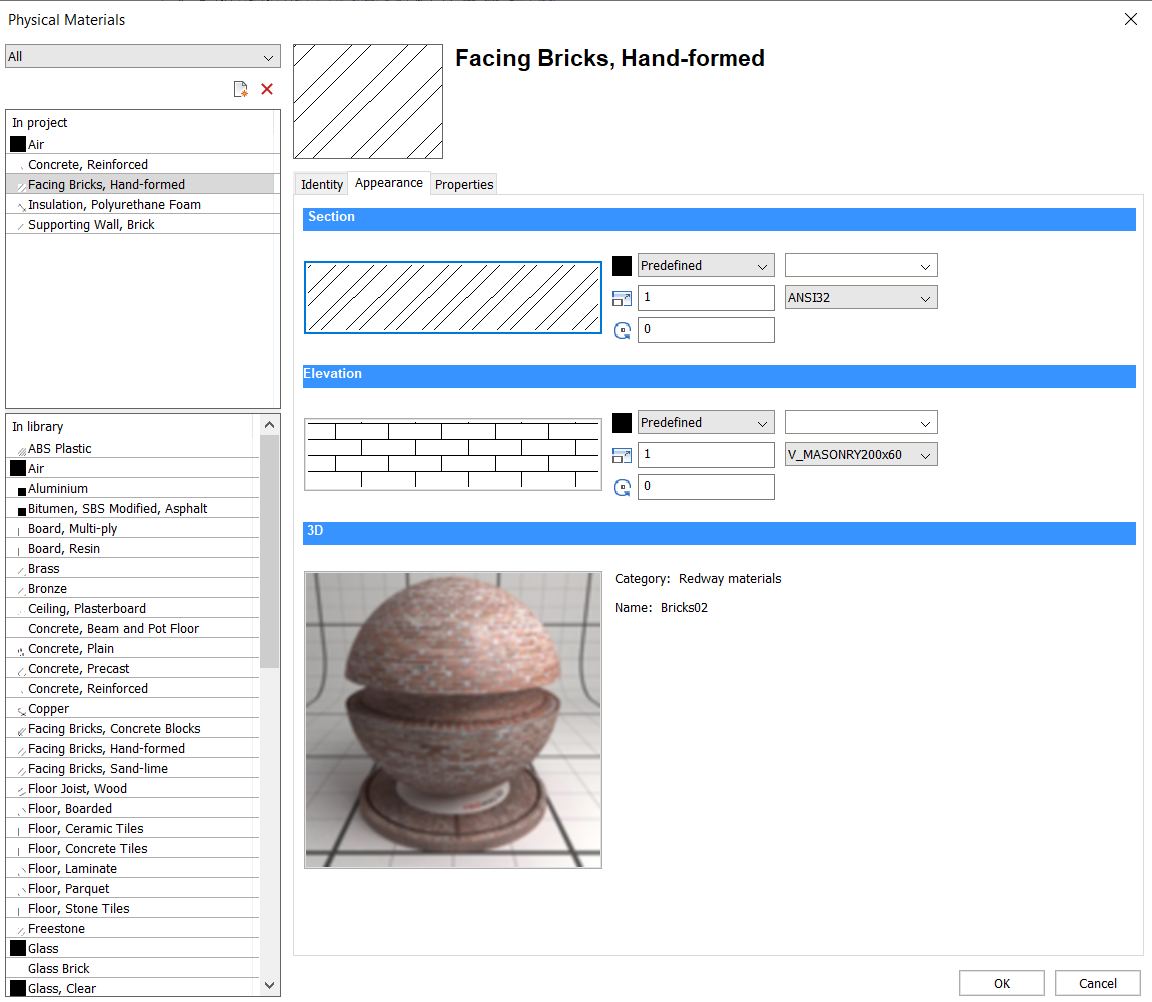

  4. In the procedure Understanding the created layers, it was stated that you can change the hatch patterns of the materials here. How you need to do this will follow in the next steps.
  5. Double-click the row of Facing Bricks, Hand-formed. The Physical Materials dialog pops-up on the material Facing Bricks, Hand-formed. To access this dialog box, you can also launch the BLMATERIALS command and select the Facing Bricks, Hand-formed material.
  6. Go to the tab Appearance.

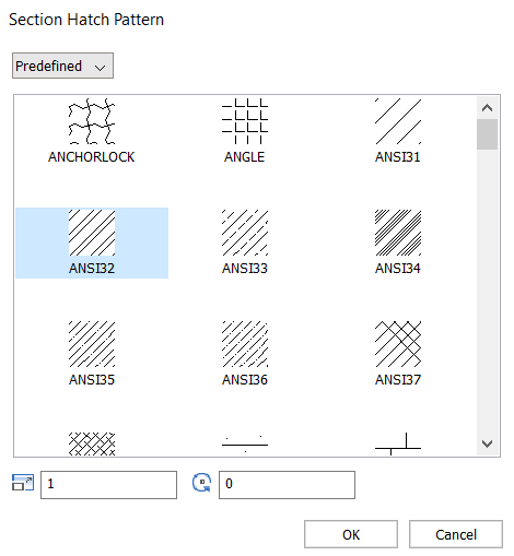

  7. Under the title Section, double-click on the hatch pattern.
  8. Choose your new standard section hatch representation for this particular material. In every composition with this material, the same hatch representation will be used.
  9. If you want to change the appearance of an elevation hatch, you can do so by double-clicking the hatch pattern under the Elevation title. The outer most visible material of a composition will be used to determine the elevation hatch.

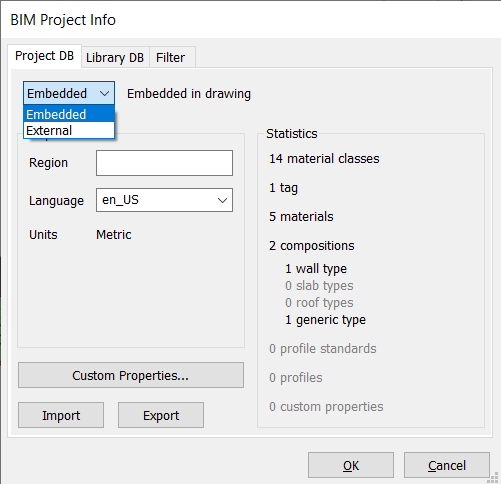

  10. Once this is finished, type in BIMPROJECTINFO in the Command line. You will enter the BIM Project Info dialog box.
  11. In the Project DB tab, switch the value for the database from Embedded to External. You will be asked to save the database on your computer and give it a name, for example, CompositionsTemplate.bsyslib.
  12. To use this database (Project DB) in a new drawing, switch the value for the database from Embedded to External, then select the BSYSLIB file you created.
