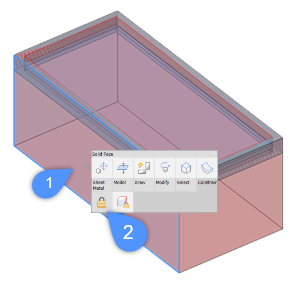

Step 2: Applying fix constraints
- Turn on the BC_SUBTRACT layer.
- Select the entities (1) you want to add a fixation to.
- (Optional) Press the TAB key to select obscured geometry.
- Choose Add Fixation (2) in the 3D constraints command group in the Quad.
The fixation appears in Mechanical Browser as Fix_1.

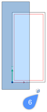

Step 3: Applying rigid constraints
- Select the entities to apply the Rigid Set constraints.
The entities remain in the same position with respect to each other when they are in a Rigid Set.

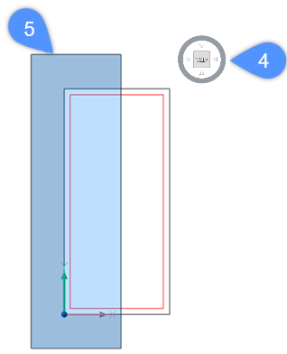

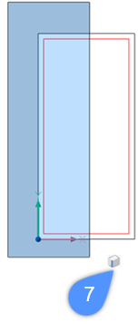

To select more than one sub-entity of the same type at a time, take the following steps:- Use LookFrom control (4), by default it is at the top right of your screen, to change the view from 3D to TOP.
- Select the entities using the selection box (5). While drawing a selection box, press Ctrl key to change the type of sub-entity selection. Every time you press Ctrl key, the type of the sub-entity selection will change. The type of the sub-entity can be seen under your mouse cursor, for instance, faces (6) or edges (7).
Note: By default, the selection boxes see and select solids.
- Choose Add Rigid Set (
) in the 3D constraints command group in the Quad. - Repeat the same process for the other sides: top, bottom, and right side.

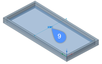

Step 4: Applying distance constraints
Command: DMDISTANCE3D
- Turn off the BIM_Subtract layer.

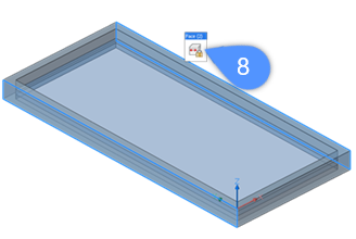

- Select the first face.
The face highlights.
- Hover over the second face.
Hit the TAB key to highlight an obscured face.
- When the second face highlights, choose Add Distance (8) in the 3D Constraints command group in the Quad.
You are prompted: Specify distance value or [Geometry-driven] <xxx.xx>:
- Do one of the following:
- Press Enter key or right-click to accept the current value.
The current value displays in the dynamic dimension field (9) when the Dynamic Dimensions (DYN) is active.
- Type a value in the Command line.
- The distance value between the two surfaces appears in the Mechanical Browser.Note: To remove any constraint in your model, select the constraint in the Mechanical Browser, e.g. fix, rigid set…, and press the Delete key or right-click and select the Delete option.

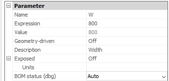

Step 5: Applying parameters

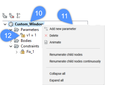

- Right-click the file name (10) in the Mechanical Browser.
- Select Add New Parameter (11) in the context menu.
The parameter settings grid is created and the parameter is added in Mechanical Browser as v1 = 1 (12).
- Select the parameter, then edit its properties in the settings grid.
The following illustration shows the properties of a Width parameter of the custom window. The table below demonstrates each property.
Name Type a parameter name. Expression Type a value or formula. Value Shows the current value of the parameter. Geometry-driven If On, makes the parameter geometry-driven (disables the Expression field). Description Define an optional description of the parameter. Exposed Controls whether the parameter is available in the properties panel when the component is inserted into a model. Units Specifies whether the parameter is linear, areal or volumetric. BOM status (dbg) Specifies if the parameter will be included into BOM. -

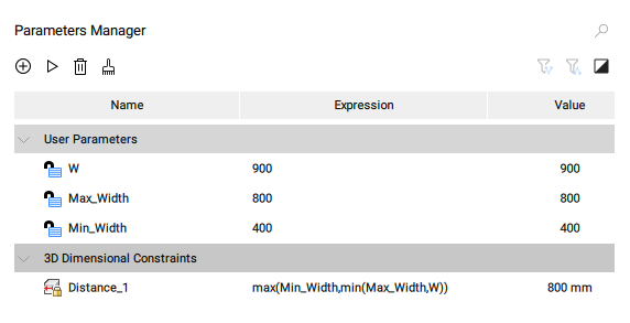

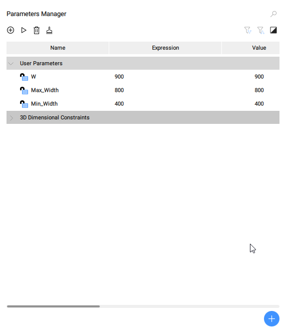

Similarly, also by using Parameters Manager panel, we can add parameters which will create upper and lower limits for window width by combining max(expression), and min(expression) expressions.

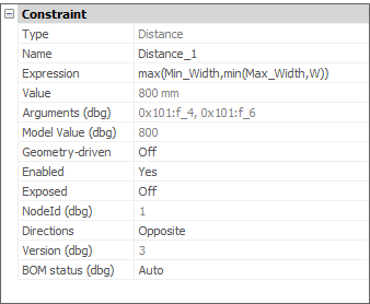

- To link the parameters you just created with the dimensional constraint, select the distance constraint in the Mechanical Browser panel and use the parameters to formulate an expression in the Expression field in the settings grid of the constraint.
For example, when W=900mm, the Distance_1 value will be 800mm:
- (Optional) Change the expression value of the parameter and press Enter. The assigned distance constraint is changed accordingly.
