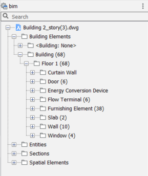

    The drawing opens with Xrefs made for each floor in each building. This allows you to easily split large files into smaller BricsCAD files.

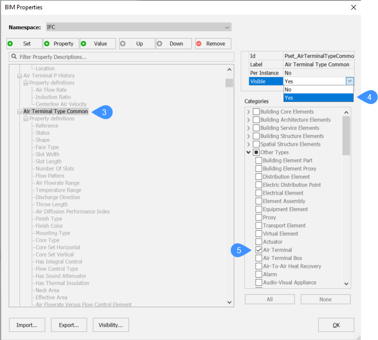

Work with IFC properties

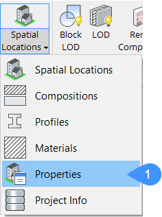

  1. Open the BIM Properties dialog box using one of these methods:
    • In the ribbon go to Home > Classify > Spatial Locations > Properties (1). The BIM Properties displays.
    • In the Command line, type BIMPROPERTIES.

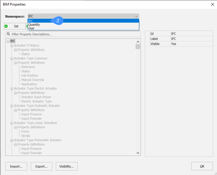

  2. Select IFC in the Namespace drop-down menu (2).
  3. Search for the desired property in the properties list (3).
  4. Set Visible (4) to Yes for the section to be visible in the Properties panel. Set to No to hide the section.
  5. In Categories select the IFC Classes you wish to display (5).
  6. Once all properties have been set, click OK.

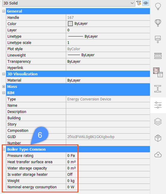

  7. Select an object of the type or category that you just enabled the Property Set for (in this example an Energy Conversion Device). Go to the Properties panel. Scroll down to the section of properties you just enabled.
  8. Fill in the data as required (6).
Note: IFC properties for spatial elements can also be added through the Properties panel.

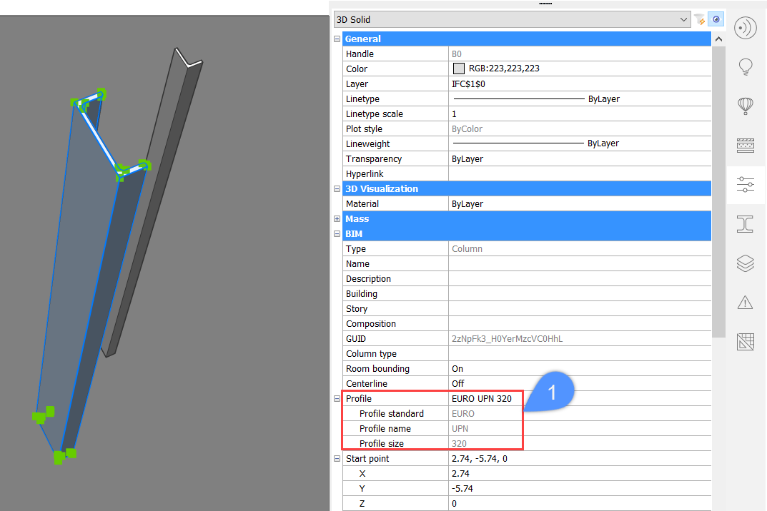

Profiles in IFC import
When importing profiles from an IFC file to BricsCAD, you can either import the profile properties in the IFC file, or let BricsCAD look for corresponding profiles in the Project and Central Database, based on the geometry. The profiles are then assigned with proper Profile Standard, Profile Name and Profile Size in the Properties panel (1).
