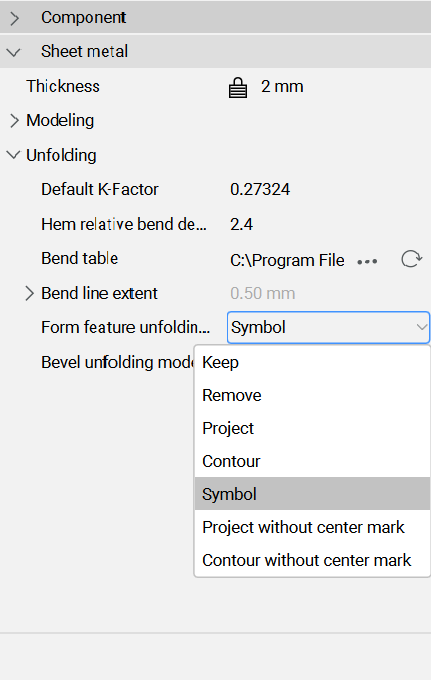

Form features are unfolded according to the Unfolding Mode setting in the Mechanical Browser.
The options are:

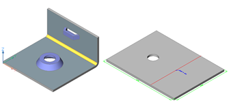

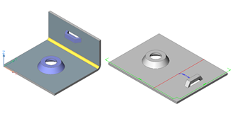

  • Keep (0): allows to keep form features geometry on the unfolded representation.
    3D model and unfolded body 2D
  • Remove (1): removes the form feature geometry from the unfolded representation.

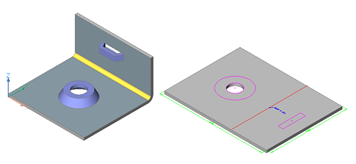

  • Project (2): generates a form feature symbol by projecting the form feature edges onto the flange plane.

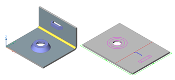

  • Contour (3): generates a form feature symbol by projecting the external contour and holes of the form feature onto the flange plane.

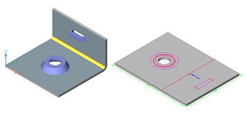

  • Symbol (4): creates the unfold symbol on the UNFOLD_SYMBOL_UP or UNFOLD_SYMBOL_DOWN layer depending on the direction of the form feature.
The unfold mode for the current sheet metal part can be set in Mechanical Browser.

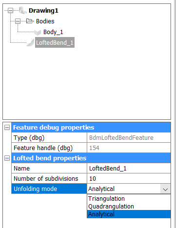

Lofted bends lying on cylindrical and conical surfaces can be unfolded analytically: the dimensions and shape of the unfolded lofted bend will be as if its middle surface was mathematically unrolled on the plane. This shape can also be achieved by a highly increased number of samples for the lofted bend. You must set the Unfolding mode individually for each lofted bend feature. If analytical unfolding is allowed, the option will be present in a drop down list:
