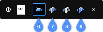

- The Extrude Hotkey Assistant appears at the bottom of the screen with a set of extrusion options.Note: The default mode is indicated by a blue frame.
- Auto (6): the result of the Auto option depends on the extrusion direction of the 3D solid and the value of the EXTRUDEOUTSIDE, EXTRUDEINSIDE, and INTERSECTEDENTITIES system variables found in the Extrude mode group.Note: The value of these variables could be 0 (= Do not modify), 1 (Subtract), and 2 (Unite).Note: The default value of these variables depends on the Workspace:

- Create (7): regardless of the extrusion direction, a new volume is created (16) from the existing solid:

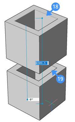

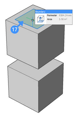

- Subtract (8): the 3D solid is subtracted from each interfering existing solid.
The following illustration shows the subtracted solids (18,19) using the highlighted boundary (17):
- Unite (9): the new volume is unified with each interfering existing solid.
The following illustration shows the situation before and after when using the extrusion tool unite option. The solid surface is highlighted (20) and the distance between the left and right face is shown with the aligned line (21). The new volume is unified (22) with the first solid:

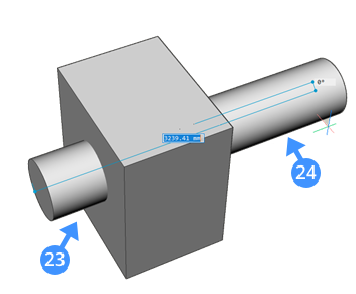

- Both sides: new symmetric volumes are created (23), (24) in both directions from the main solid:
To create symmetric volumes from the existing solid, type B in the Command line, which corresponds to Both sides option of the EXTRUDE command.

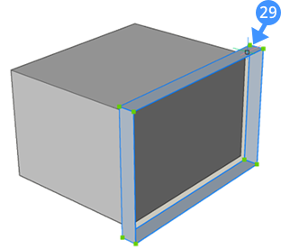

The following illustrations show the created surface (29) by extruding the selected 2D entity (28) in the drawing:
