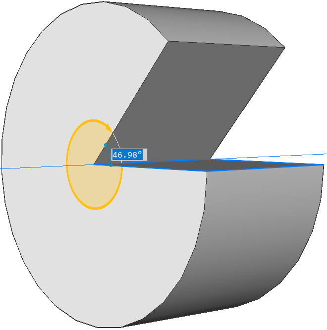

Angle of revolution
Specifies how far around the source entity is rotated about the axis.
Note: You can specify the angle of revolution dynamically, using the Manipulator, or typing a value.
Auto
Move the mouse to specify the angle direction.
