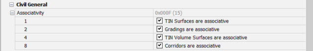

- Associativity
Enable/disable grading, surface and corridor associativities.
By default, the system variable is set to 15.
0: Neither TIN surface, grading nor corridor associativity is enabled.
1: Enables TIN surface associativity.
2: Enables grading associativity.
3: Both TIN surface and grading associativities are enabled.
4: Enables TIN volume surface associativity.
5: Both TIN surface and TIN volume surface associativities are enabled.
6: Both grading and TIN volume surface associativities are enabled.
7: TIN Surface, Grading and TIN volume surface associativities are enabled.
8: Enables corridor associativity.
9: Both TIN surface and corridor associativities are enabled.
10: Both grading and corridor associativities are enabled.
11: TIN surface, grading and corridor associativities are enabled.
12: Both TIN volume surface and corridor associativities are enabled.
13: TIN surface, TIN volume surface and corridor associativities are enabled.
14: Grading, TIN volume surface and corridor associativities are enabled.
15: All TIN surface, grading, TIN volume surface and corridor associativities are enabled.

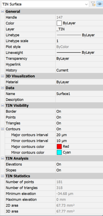

Properties of a TIN Surface
- TIN Visibility
- Defines the visibility of the TIN surface elements.
- Boundary line
Changes visibility of the outer boundary on a TIN Surface.
- Points
Changes visibility of points on a TIN Surface.
- Triangles
Changes visibility of triangles on a TIN Surface.
- Contours
Defines the visibility of contours on a TIN Surface.
- Major contours interval
Sets the major contours interval.
- Minor contours interval
Sets the minor contours interval.
- Major contours color
Defines the color of the major contour.
- Minor contours color
Defines the color of the minor contour.
- TIN Analysis
- Defines the parameters for displaying elevations and slopes analyses.
- Elevations
- If ON, the elevation analysis is displayed on a TIN Surfaces.
Choose Edit… option to open the Elevation Analysis dialog box, where you can define or modify the elevation analysis parameters.
- Slopes
- If ON, the slope analysis is displayed on a TIN Surface.
- TIN Statistics
- Displays the TIN Statistics.
- The number of points
Displays the number of TIN Surface points.
- The number of triangles
Displays the number of TIN Surface triangles.
- Minimum elevation
Displays the minimum elevation value found in the TIN surface.
- Maximum elevation
Displays the maximum elevation value found in the TIN surface.
- 2D area
Displays the 2D area of the TIN surface.
- 3D area
Displays the 3D area of the TIN surface.

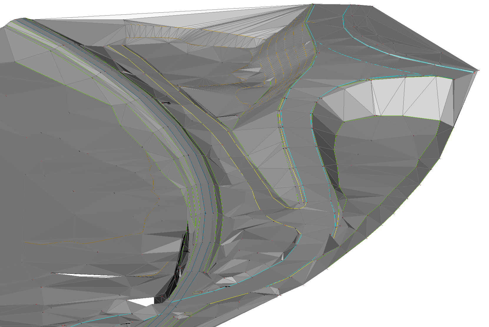

Note: The TIN surface algorithm connects triangles outside the boundary of the concave clipping polygon. In such areas, long and narrow triangles are created, which can be removed with the TINEDIT command. - Launch the TINEDIT command and select the Remove Outer Edges option. Then specify the maximum triangle length. Triangles that are longer than specified value are removed.
