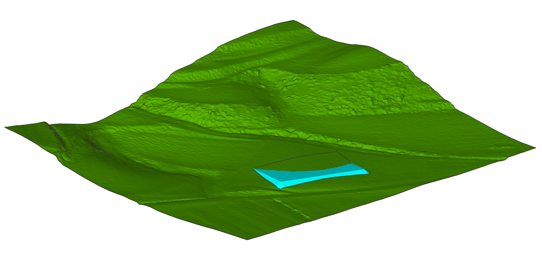

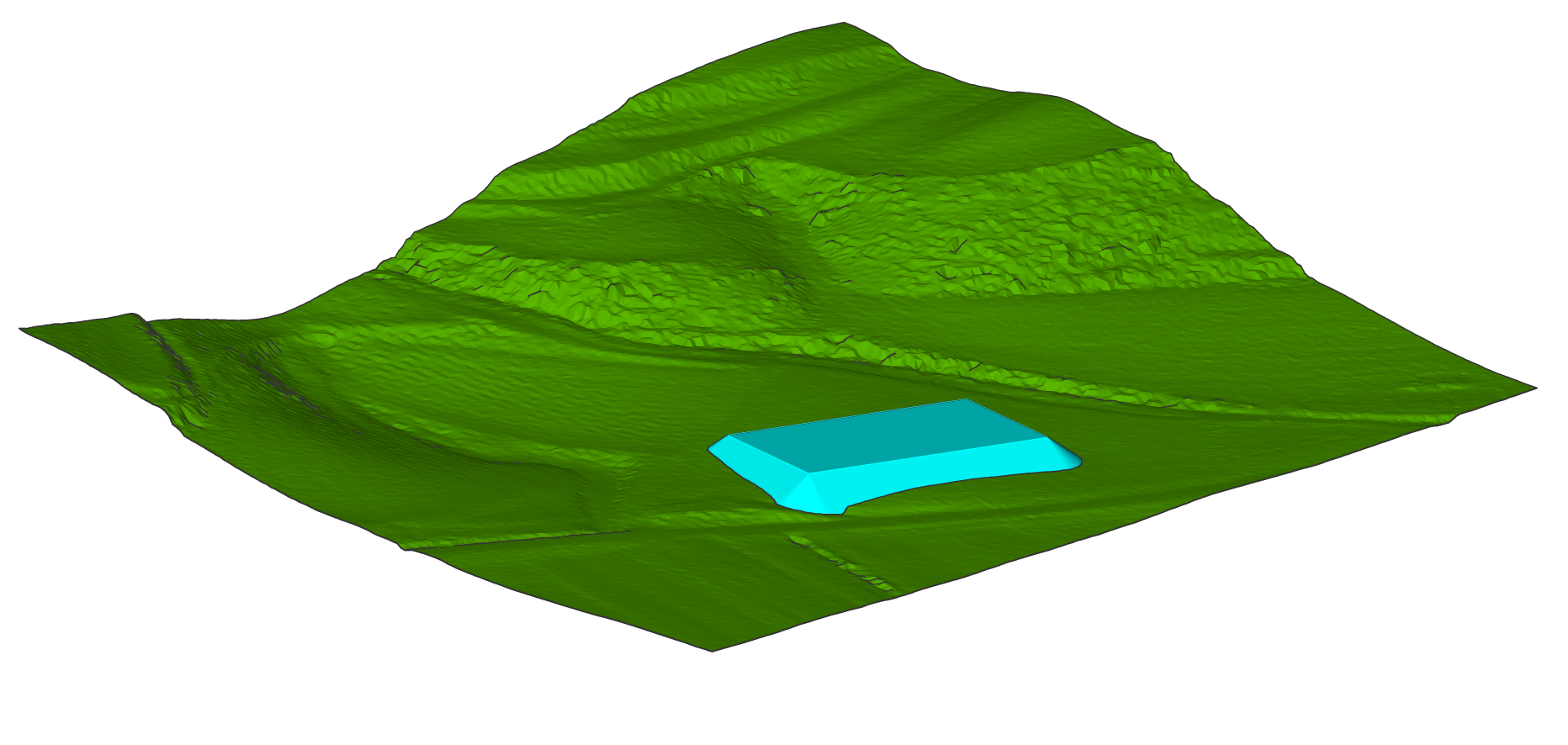

Grading a surface to create a pond

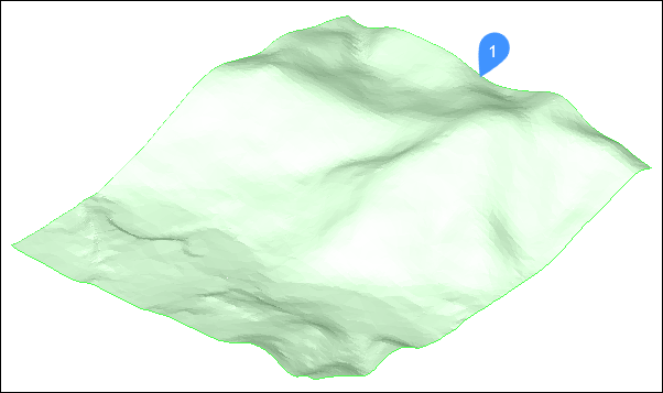

  1. Open a drawing that has a topographical surface (1).
  2. Launch the GRADING command.

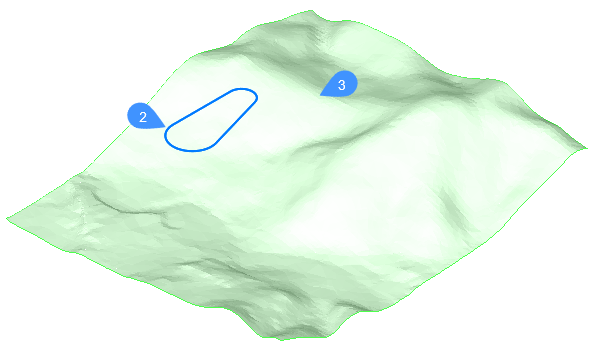

  3. Select the input entity (2) that defines the footprint area of your pond. Different types of opened and closed entities are accepted as input entities, such as lines, polylines, 2D/3D polylines, arcs, 3D Alignments, and gradings.
    Note: Before selecting the target surface, you can change to slOpe/offset projection method which requires an input entity, offset and slope.
  4. Select the target surface (3).
  5. Select a part of the entity by picking the start and end points, or the Entire length of the entity.
  6. Define the slope of the grading.

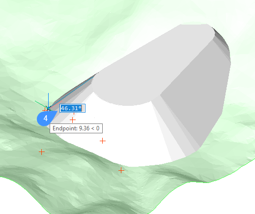

    Note: The grading is attached to the input entity, and it is connected with the target surface (TIN surface). Moving the mouse in/out dynamically increases/decreases the slope of the grading.
    Note: If DYNMODE variable is set to 3, you can also input the slope angle directly from keyboard (4).
  7. Press ENTER to accept the slope of the grading.

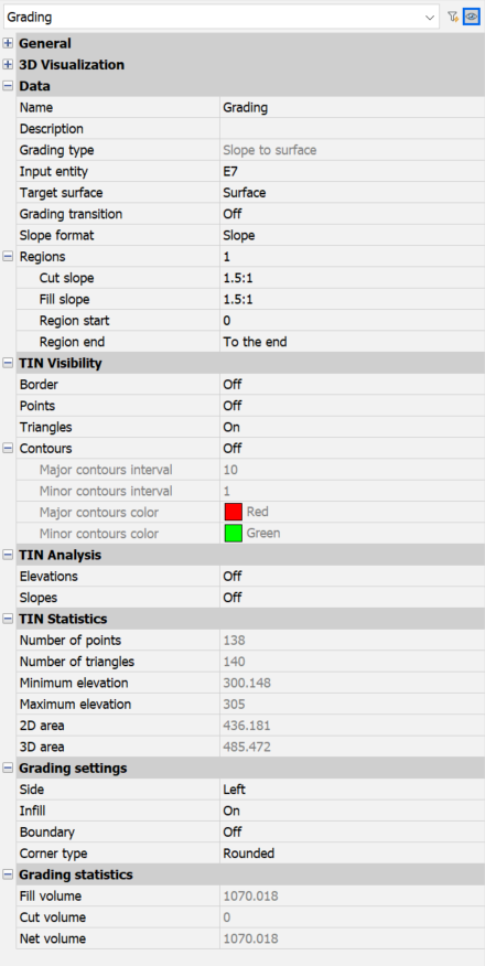

Displaying the properties of a graded surface
The properties are displayed in the Properties panel after selecting the grading.
Grading type
Displays which projection method is used to grade the surface (Slope to surface or Slope and offset).
Input entity
Displays the handle number of the input entity.
The input entity can be changed by pressing the three dots button () on the right side of the Input entity option and selecting another input entity on the screen.
Target surface
Displays the name of the target surface.
The target surface of a grading can be changed by pressing the three dots button () on the right side of the Target surface option and selecting another target surface on the screen.
Grading transition
Displays the grading transition status.
Slope format
Allows you to select a slope format from the drop-down list.
Grade
Sets the grade for the slope format.
This is the default option for the slope format.
Slope
Sets the slope for the slope format.
Degrees
Sets the degree for the slope format.
Cut slope
Displays the cut slope (start and end).
Fill Slope
Displays the fill slope (start and end).
Note: The Cut slope and Fill Slope display values based on the selected Slope format.
Region start
Displays the start of the region.
Region end
Displays the end of the region.
As the grading is derived from the TIN surface, you have access to TIN Visibility, TIN Analysis and TIN Statistics properties. You can also calculate the TIN Volume Surface and extract the TIN surface.
Side
Controls on which side of the input entity the grading is drawn (left or right).
Infill
The internal area of entities is filled if this option is turned on. Valid for closed entities only (circle, closed polyline).

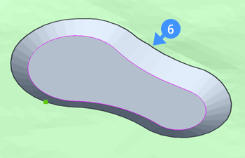

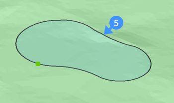

Boundary
Controls the boundary of the grading. When the grading boundary is on, that boundary is added as a hide boundary to the target surface.

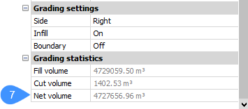

The following images show when the grading boundary of the pond is off (5) and on (6). Based on the grading boundary, the net volume for the body of the pond is calculated and can be found in the properties panel (7).
Fill volume
Displays the fill volume for a body/shape limited with the target surface and graded surface.
Cut volume
Displays the cut volume for a body/shape limited with the target surface and graded surface.
Net volume
Displays the net volume for a body/shape.

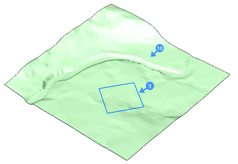

Grading a surface to create a platform

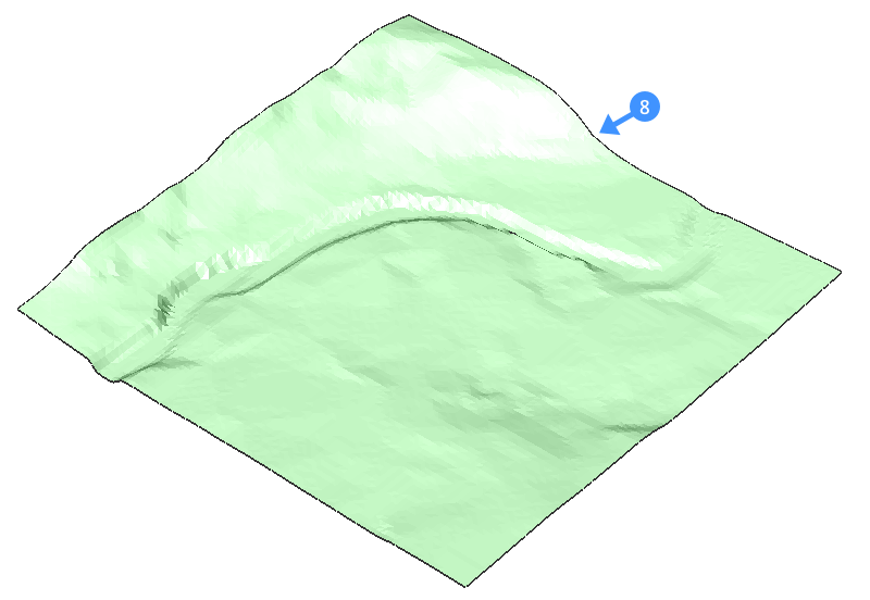

  1. Open a drawing that has a topographical surface (8).
  3. Select the entity that defines the footprint area of your platform (9).
    Note: Before selecting the target surface, you can change to the slOpe/offset projection method which requires an input entity, offset and slope.
  4. Select the target surface (10) to create a graded area.
  5. Select the Entire length of the input entity.

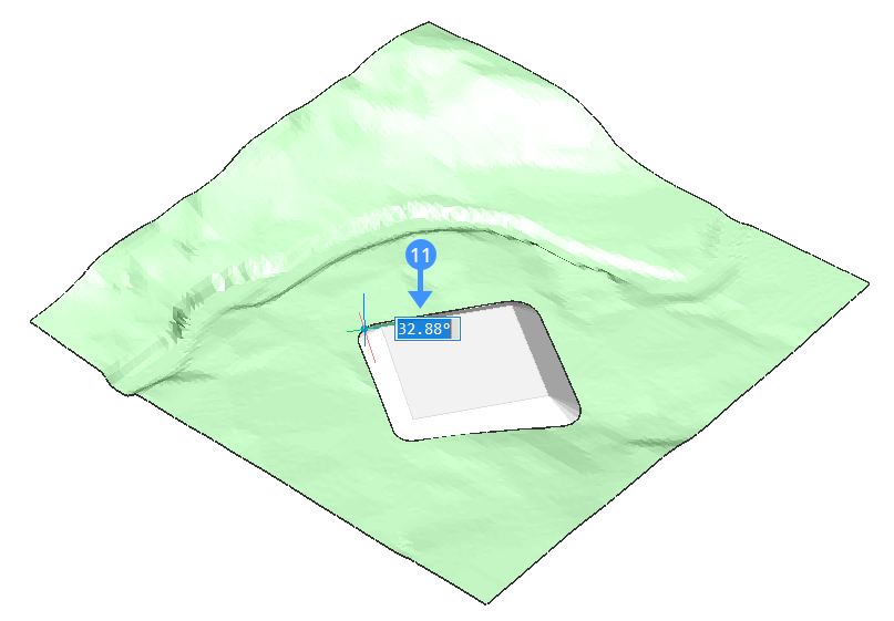

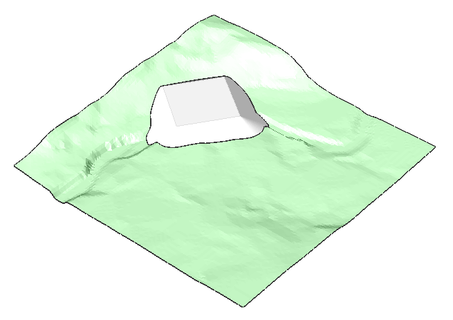

    Note:
    • The grading is attached to the input entity, and it is connected with the target surface. Moving the mouse in/out dynamically increases/decreases the slope of the grading.
    • If DYNMODE variable is set to 3, you can also input the slope angle directly from keyboard (11).

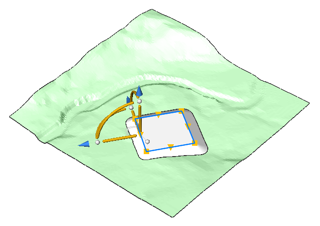

    Note: You can easily move the platform that you created. Do this by using the manipulator on the entity from which you created the platform. You can move both horizontally and vertically.
    The grading will automatically be adapted to its surroundings.

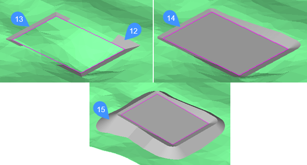

Merge steps:
  • Merge Grading1 (12) and Grading 2 (13).
  • Connect the grips to close the grading. The resulted grading is (14).
  • On the basis of the resulting grading (14) create another grading, that is sloped to the TIN surface, and turn OFF its Infill parameter. The resulted grading is (15).
12: Grading 1
13: Grading 2
14: Merged Grading with connected grips
15: The resulted Grading with Infill parameter set to OFF

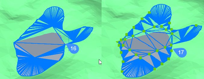

Split
16: Grading before splitting.
17: Grading after splitting. Each region can be edited by moving the grips.
