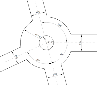

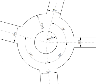

Two versions of the same fully constrained drawing representing a roundabout:
