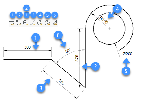

Dimensional constraints control the dimensions of 2D entities.
  • Horizontal distance (1) (DCLINEAR and DCHORIZONTAL commands).
  • Vertical distance (2) (DCLINEAR and DCVERTICAL commands).
  • Distance between points or the length of lines and polyline segments (3) (DCALIGNED command).
  • Radius of arcs, circles and arc polyline segments (4) (DCRADIUS command).
  • Diameter of arcs, circles and arc polyline segments (5) (DCDIAMETER command).
  • Angle between entities or between points and entities (6) (DCANGULAR command).

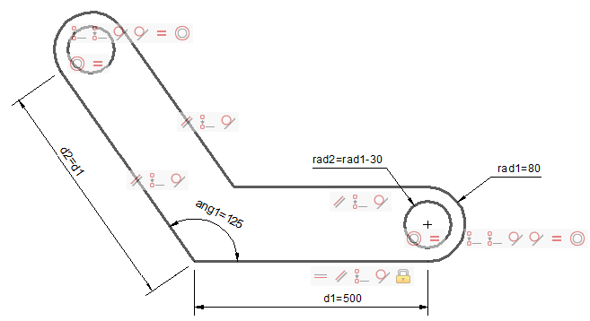

Using expressions to define dimensional constraints
Dimensional constraints are named automatically upon creation.
The naming rules are as follows:
  • distance: d1, d2, d3, ...
  • radius: rad1, rad2, rad3, ...
  • diameter: dia1, dia2, dia3, ..
  • angular: ang1, ang2, ang3, ..
The name of a constraint can be used as a parameter in a mathematical expression to define another dimensional constraint.
The dimensions of the bracket below are controlled through the rad1 radius, d1 distance and ang1 angular dimensional constraints.
The radius of the hole (rad2 ) and the length of the second leg (d2 ) are defined by expressions.
Geometric constraints force the width of the second leg and the hole in it to be equal to the first leg.
