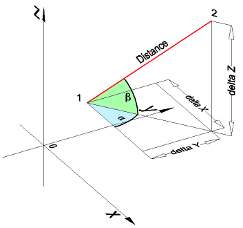

    BricsCAD® prints the results in the Command line:
    Distance, Angle in XY Plane (α), Angle from XY Plane (β)
    Delta X, Delta Y, Delta Z
    The values are in drawing units and with respect to the current coordinate system.
