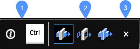

When the Hotkey Assistant widget is On, it automatically appears during supported commands and disappears when the command ends.
  1. Information
  2. Options
  3. Dismiss
Information
Informs you to press the Ctrl key on the keyboard to switch between the widget options.
Options
Displays the options within the widget.
Note: The options within the widget depend on the command you launched.
Dismiss
Dismisses the currently displayed Hotkey Assistant widget and deactivates it for the current command.

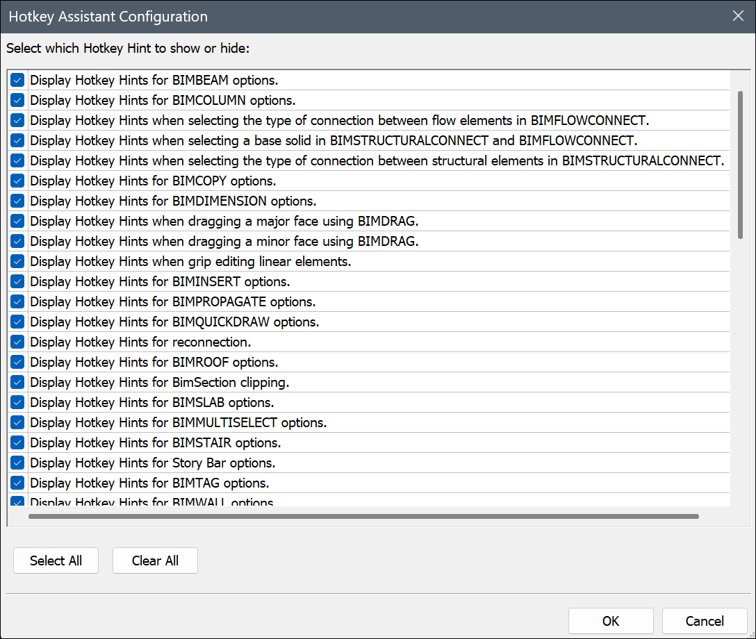

Deactivating or reactivating the widget for certain commands or actions
The Hotkey Assistant Configuration dialog box allows you to deactivate or reactivate the widget for certain commands or actions.
To open the Hotkey Assistant Configuration dialog box, right-click the HKA button in the Status Bar and click the Configure... option.
Note: The Hotkey Assistant widget appears only for the Hotkey Hints that are checked.
