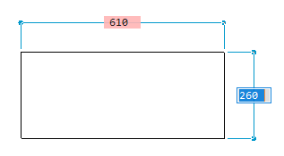

  • Dynamic dimensions: When dynamic dimensions are switched ON, you can enter distances and angles in dynamic dimension fields. When multiple dynamic dimension fields display, for example when drawing a rectangle, press the Tab key to switch to the next field. When you enter a value and press the Tab key, the field turns red, which indicates that the value is fixed.
