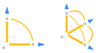

By default, the Manipulator displays when selecting an entity by a long click (keeping the left mouse button down a bit longer).
The anchor point of the Manipulator is located at the closest grip point, with respect to the selection point.

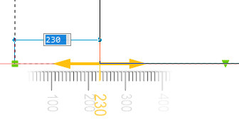

- Axes, to move along the axis:

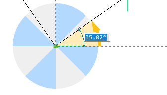

- Arcs, to rotate:

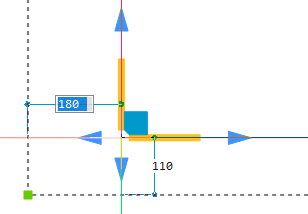

- Plane swatches (= squares at the anchor point), to move freely in the selected plane (XY, XZ or YZ):

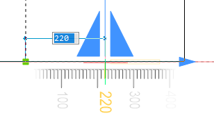

- Arrow heads, to mirror:
Note: The step size of the ruler depends on the zoom factor. Zoom in to decrease the step size, zoom out to increase.
