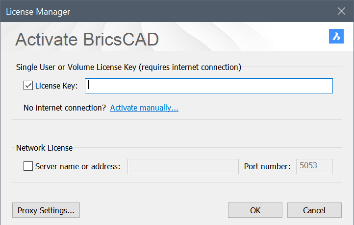

- Click the Proxy Settings... button in the or the Licensing Information dialog box.
The dialog box opens.

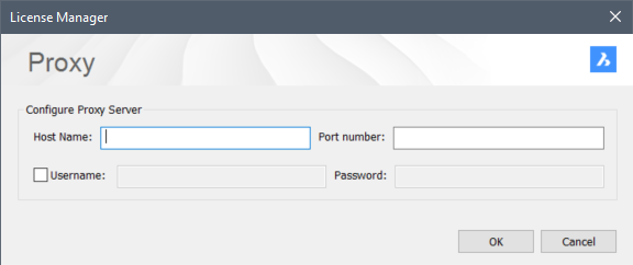

- Complete the necessary fields in the dialog box.
- Click the OK button to continue.
Note:
- The proxy settings configuration remains active for the current BricsCAD® session only. If you need to reactivate or deactivate a license in a future session, you will have to reconfigure the proxy settings.
- The proxy server is also configurable from the Proxy settings section in the Settings dialog box.
