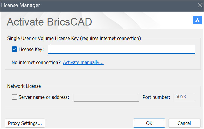

  2. Launch the LICENSEMANAGER command to open the BricsCAD License Manager dialog box.
  3. Click the Manage License button to open the License Manager > Licensing Information dialog box.
  4. Click the Modify button to open the License Manager > Activate BricsCAD dialog box.
  5. Retrieve your key from the My Licenses section in your account (see also the Where can I find my licenses? article).
  6. Paste your license key in the License Key field.
  7. Click the OK button to activate the license.
