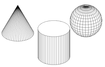

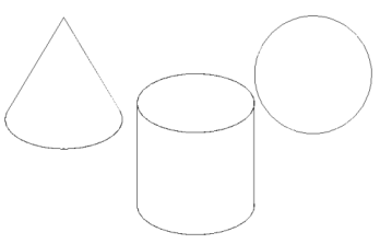

(*) Set the DISPSILH system variable On to display silhouette lines instead of a polygon mesh for curved surfaces.
Hidden line of a cone, a cylinder and a sphere with DISPSILH Off (top) and On (bottom).
