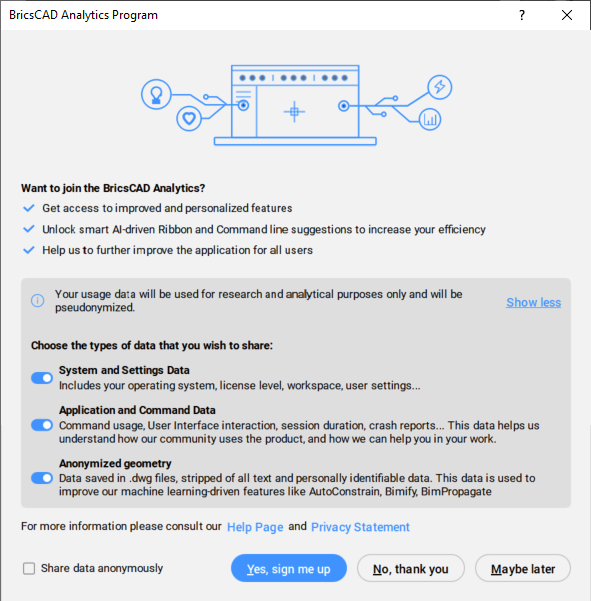

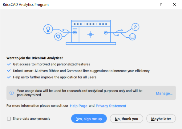

When you launch BricsCAD the second time or press Sign Up button from AI Predict ribbon tab, a dialog box displays asking you to participate in the Analytics Program.
Click the Manage... button to choose the types of data you wish to share.
If you choose No, thank you, the BricsCAD Analytics Program is turned off. If you choose Maybe later or you close the dialog box, the BricsCAD Analytics Program dialog box will appear again next time you open BricsCAD.
If you choose Yes, sign me up, you sign up for the BricsCAD Analytics Program. The BricsCAD website opens, allowing you to log in to your BricsCAD account. For more information on how to log in, see the Log in with your account article.
If you tick the Share data anonymously checkbox and press Yes, sign me up, you will be logged in as a guest.

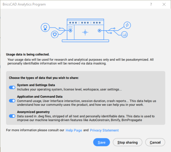

When you are logged in, the Analytics Settings button available in the AI Predict ribbon tab opens the BricsCAD Analytics Program.
By choosing Save, the BricsCAD Analytics Program collects the selected data.
By choosing Stop sharing, the BricsCAD Analytics Program is switched Off.
By choosing Cancel, the BricsCAD Analytics Program dialog box closes.
