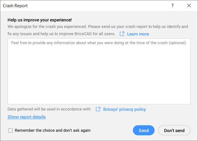

Sending crash reports via Crash Report dialog box
Next to the automatic sharing of crash report data for users that are part of BricsCAD Analytics Program, BricsCAD offers you the possibility to manually send crash information. You can set your preferences via the Crash Report dialog box.
Upon the first application startup after a crash, the Crash Report dialog box is displayed automatically. From here, you can inspect the crash report details by clicking Show report details. See the Crash Report dialog box article.
Buttons are offered to either send, or don't send the report of the latest crash.
For Send option, the following information is sent: crash report file, operating system, RAM usage during the crash, a unique identifier of the crash, the application uptime at the time of crashing. Optionally, you can provide more information about the context of the crash, for example:

If the Remember the choice and don't ask again checkbox is not ticked, the Crash Report dialog box will be displayed again after a crash occurs. If ticked, this dialog box will never be shown again and the sending preference will be set to automatic sending or never sending depending on whether Send or Don't send will be pressed.
Your choices are stored with the CRASHREPORTSENDING system variable. Its value can be changed anytime via the Command line or the Settings dialog box.
