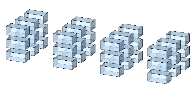

ARRAYRECT command
Creates a rectangular array of entities.
Associatively distributes copies of entities into any number of rows, columns and levels.

- Rows
- Specifies the number of rows, the spacing between subsequent rows and the incremental elevation.
- Distance
- Specifies the distance between subsequent columns/rows.
- Total
- Specifies the distance between the first and the last column/row.
- Incrementing elevation between rows
- Specifies the increasing or decreasing elevation for each subsequent row.
- Levels
- Creates 3D arrays by specifying the number and spacing of levels.
