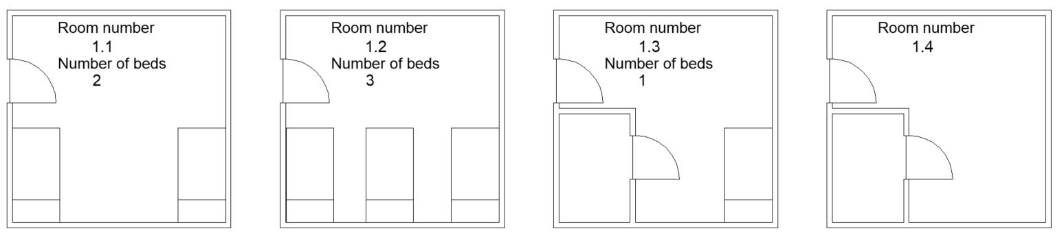

Room number 1.1
Number of beds: 2
Room number 1.2
Number of beds: 3
Room number 1.3
Number of beds: 1
Room number 1.4
