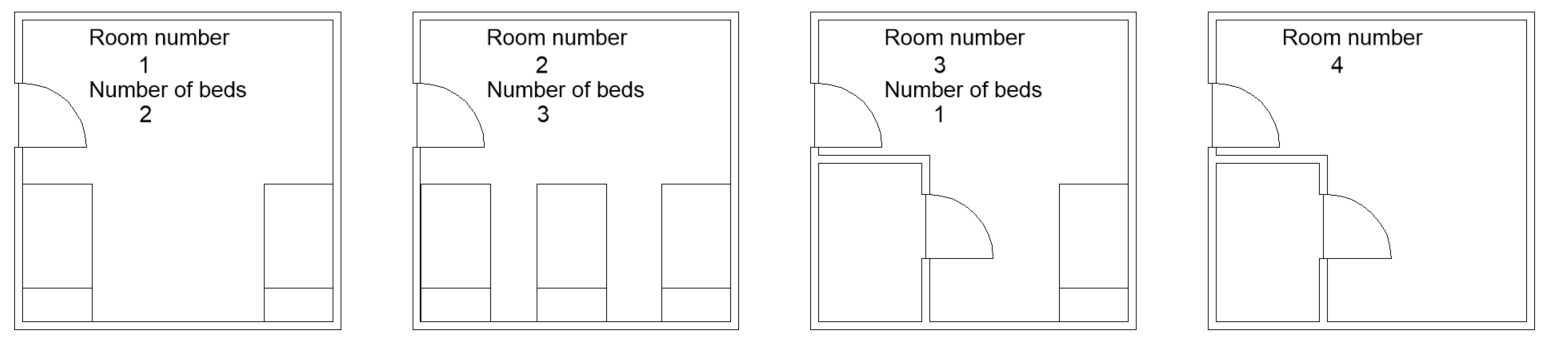

Room number 1
Number of beds: 2
Room number 2
Number of beds: 3
Room number 3
Number of beds: 1

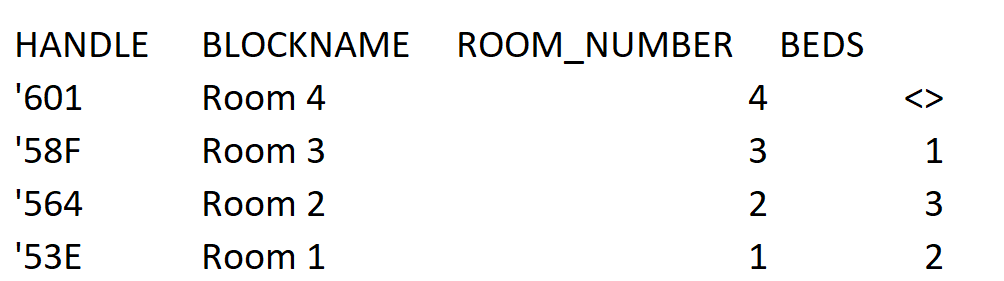

Room number 4
The output of the ATTOUT command is a .txt file. The file contains information of the selected blocks ordered in a table. The HANDLE and BLOCKNAME column give the handle and block name of a block, the additional columns give the values of the block attributes. Each row represents a block reference and its values of the attributes.
