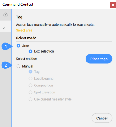

The command opens the Tag command context panel to let you access the options and see useful messages and instructions.
  1. Auto
  2. Manual
Auto
Creates tags automatically for all sectioned building entities in the selected viewport, including section indicators, story indicators, and grid callouts.
Box selection
Creates tags for all entities in a selected area of viewport. After selecting the area, click the Place tags button to have the tags created in the viewport.
