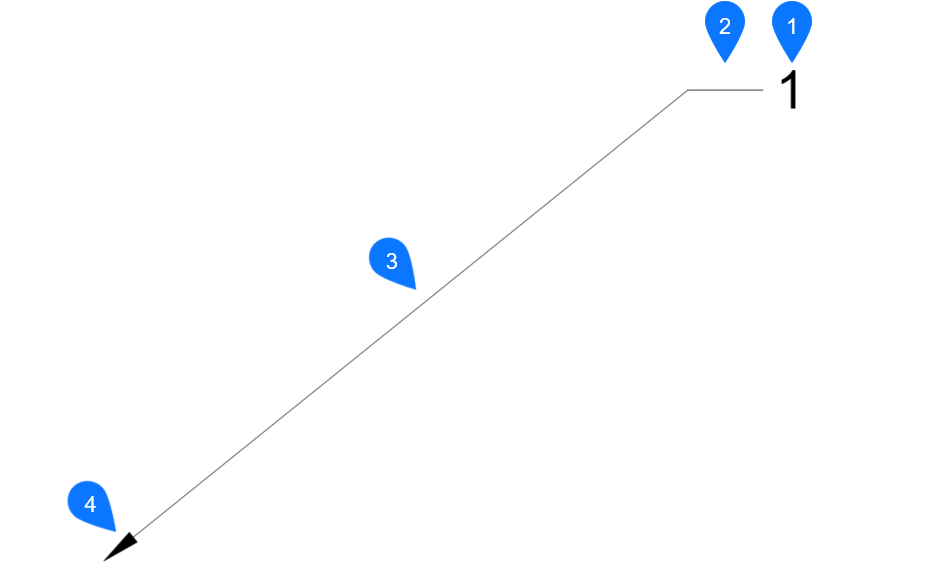

Creates a multileader with three components: a leader line with an optional arrowhead, a landing line and the content, such as text or a block. Multileaders support more than one leader line per content.
  1. Mtext/block
  2. Landing
  3. Segment
  4. Arrowhead

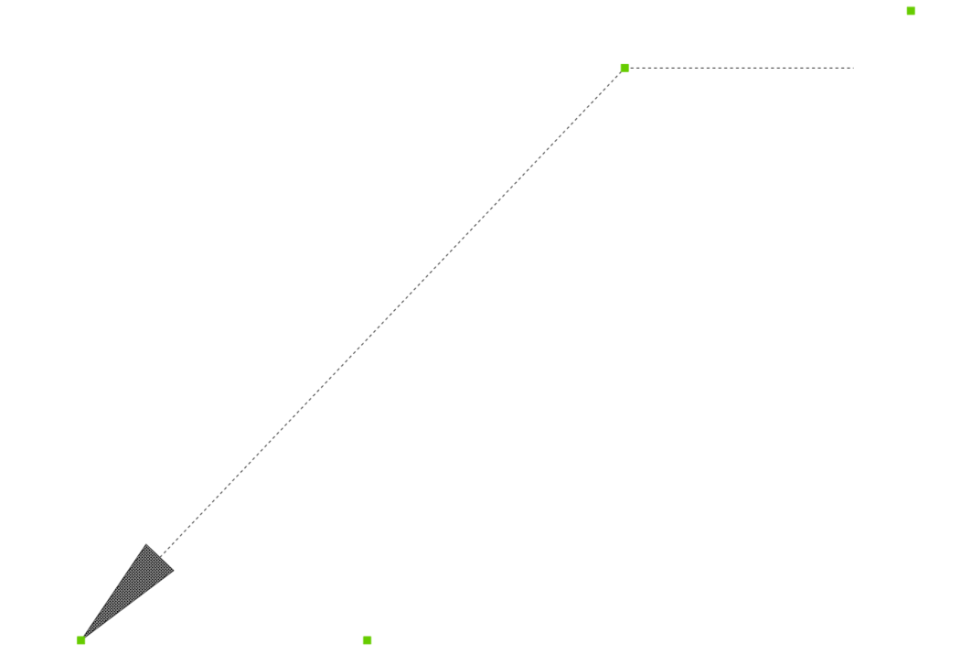

  • You can edit the grip points of the multileader by clicking the green squares.
