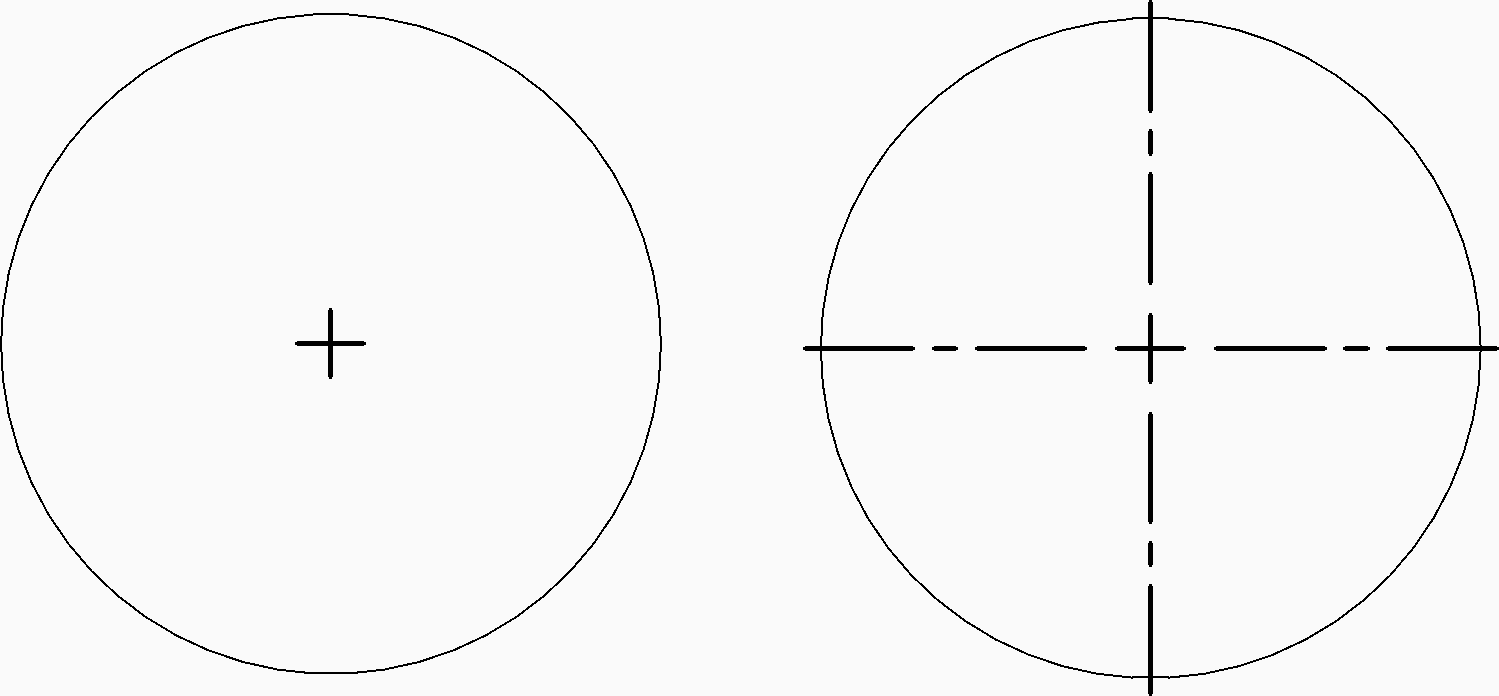

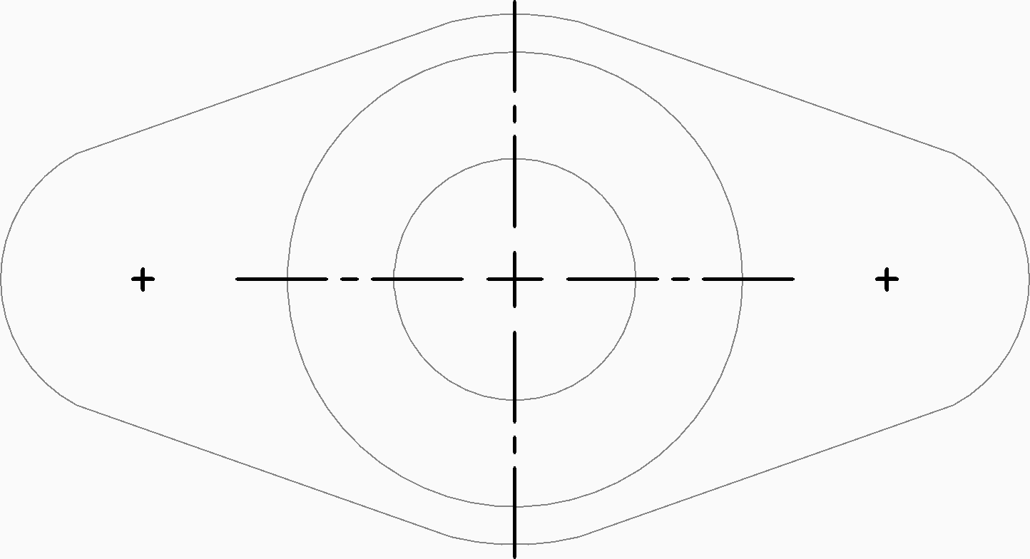

Begin creating a center mark by selecting a circle, arc or polyarc. Depending on the current value of the CENTERMARKEXE system variable, the center mark is drawn with or without extension lines. Additional system variables further control the appearance of centermarks.
The center mark is associative, so when the arc or circle is moved or resized, the centermark follows.
