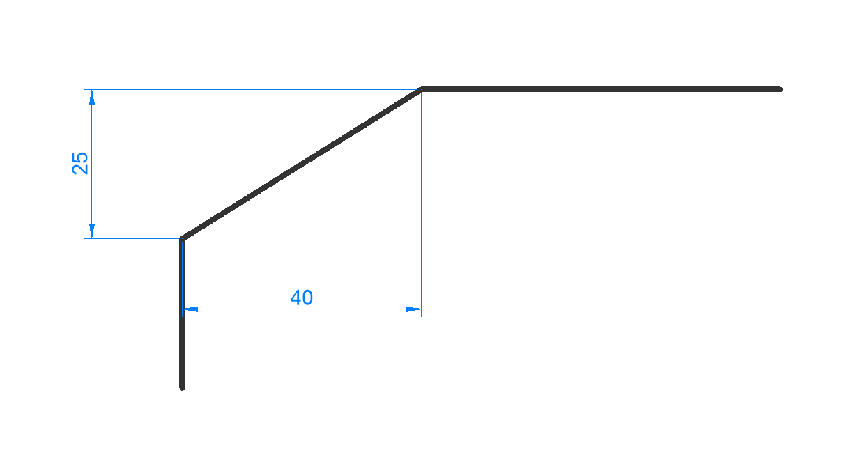

  • specifying two distances

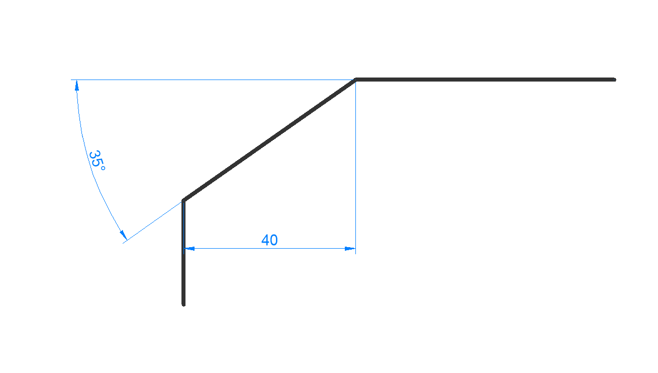

  • length and angle

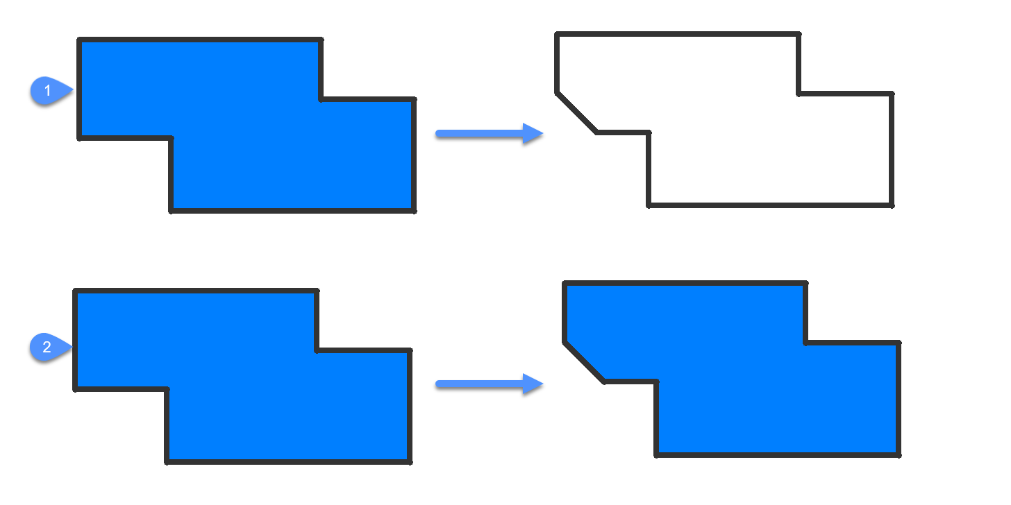

Polyline
Chamfers the vertices where two segments meet of the selected polyline (if applicable).
Note: Creating chamfers on a hatch boundary created with individual lines (1) results in removal of hatch associativity. Associativity is maintained if the boundary is defined from a polyline (2).

Angle
Changes the method to length-angle.
Note: BricsCAD measures the angle from 0 degrees, the X axis.

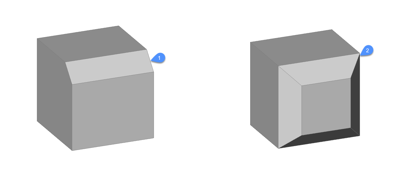

Select edge
Selects only one edge (1) of the base surface to be chamfered.
Loop
Loops around selecting all tangential edges belonging on the base surface (2) to be chamfered.
